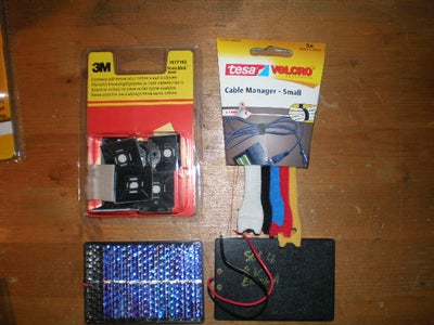

1) for the solar panel:
- 4 Encapsulated 2V/200mA solar panels (Velleman SOL4).
- Self adhesive pads for cable ties (3M Scotchlok Ab02).
- Nylon cable ties to fit the adhesive pads above.
- Velcro adjustable cable binders (Tesa 55236-00000, 12mmx20cm).
- Heat shrink tubing.
- Electric wire (capable of carying 0.5A is more than enough).
- Connector to go to the battery box.

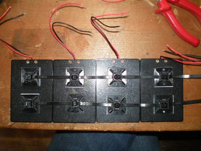

Step 2: Assemble the Solar Panel:

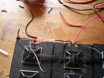

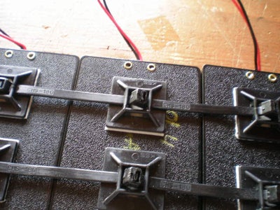

- Attach two adhesive Scotchlok pads per encapsulated solar panel on the back.

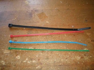

- Use nylon cable ties of correct size to lace the panels together. The "head" of the ties goes in the middle of the pads. This fixes the position of the small solar panels.

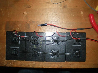

- Connect the panels in series (red-to-black etc) and solder. Insulate with heat shrink tubing.
- At the end you will have a black and red cable ( minus and plus). Solder a 0.5m cable to this and attach a connector plug to go to the battery box, as in the picture.
Tip: I placed 4 panels in a row. You can also place them in a rectangle or other shape that fits your backpack, the important part is that the small panels have a more or less fixed position relative to each other, so they don't slide over each other.

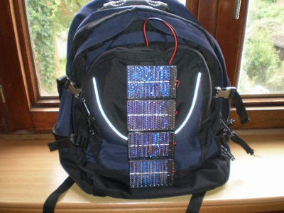

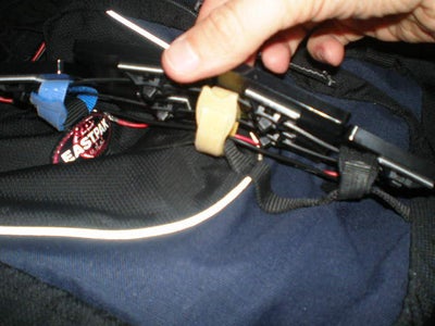

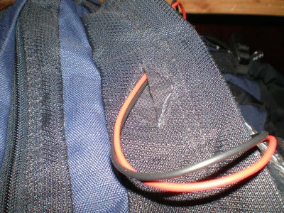

Step 3: Attach the Panel to Your Backpack:
Now comes the "detachable" part.
Attach the panel using the velcro cable binders and whatever nooses you have on your backpack.
To get the power cable to the inside, I used the opening that's there for headphone cables.

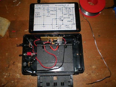

I used the second method in my battery box to prevent overdischarging the batteries: when the voltage is above 1.2V / cell (4.8V for the pack) the output is connected. Then, when the voltage drops below about 0.9V/cell or 3.6V for the pack, the output is disconnected, until the solar panel charges the batteries sufficiently again. In this way you do not need to wurry about overdischarging.

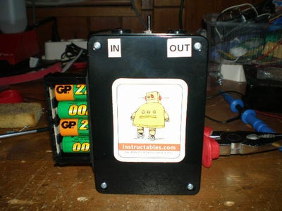

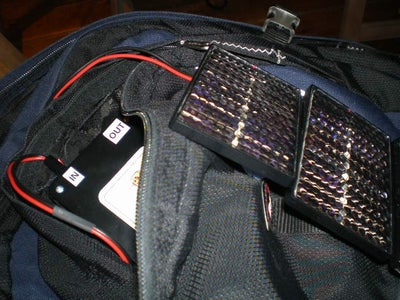

Step 5: The Charger/battery Box (2):
Now build the battery box.
Drill holes for the connectors, one coming from the solar panel and one to go to your gizmos.
I used the same type of connector for both, in hindsight it's better to use different types.
Prepare box for battery holder if necessary.
The batteries go in a battery holder with a slide door, for which a rectangular hole in the side of the box had to be cut.
Glue the circuit diagram in the lid of the box, in case you'll ever have to open it again.
Glue the circuit board in the box with hot melt glue (or use any other method you like).
Label the box "in" for solar panel and "out" for loads.

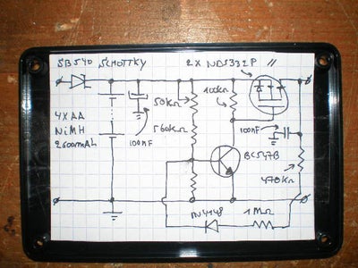

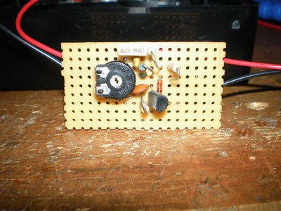

The circuit is built on a piece of perfboard (note the MOSFETs I used are SMD and placed on the underside of the board). Nothing is crictical in this circuit, for all components you can use replacements:
- The diode can be any Schottky diode capable of something like 30V/ 0.5A.
- The p channel mosfet needs a low on voltage (Vsg<3.9V at currents you like to use it), it should also have low Rdson (<0.2 ohm or so) you can parallel them to increase current handling capability.
- The resistor from base to emitter of the BC547 is 62kohm, I forgot to label it.
Adjustment:
Once the circuit is ready, connect a load (say 100 ohm).
Then using a power supply, go up slowly starting from zero volts. Adjust the trimmer so the circuit trips at 4.8V. Then go down again, the circuit should disconnect the load somewhere between 4.0V en 3.6V NOT LOWER. To adjust the lower threshold, you can also replace the 470kohm resistor with a trimmer if needed.
Step 6: Put the Box in Your Backpack and You're Done!

    lucidn
    lucidn
    13 years ago on Introduction
    Do you happen to have a larger version of the charge box schematic? It's a bit tough to understand.
    0
    Kajnjaps
    Kajnjaps
    Reply 13 years ago on Introduction
    I'm sorry, I don't. It basically is a just schmitt trigger with two transistors. Let me know if you have a specific question I can help with.

    lucidn
    lucidn
    Here's a few questions How are the ND5332Ps hooked up? Does the gound refer to the ground of the battery, or the ground of the solar panels? And I'm a bit confused about how the panels are hooked up. And help would be much appreciated, as I'm designing a PCB for this.
    0
    Kajnjaps
    Kajnjaps
    Hi Lucidn, the NDS332P (Fairchild Semiconductor) are in parallel, meaning gate to gate, source to source and drain to drain. You can always do this with mosfets to increase the current capability (note: don't do this with bipolar transistors, as they have a negative resistance temperature coefficient). The solar panels are in series so you end up with two wires, positive (red) and a negative (black) . The black wire is the ground for the system,so for batteries, the circuit and the solar panels. If you are going through the trouble of designing a pcb for this, it might be a good idea to include a variable resistor in series with the 1Mohm.
