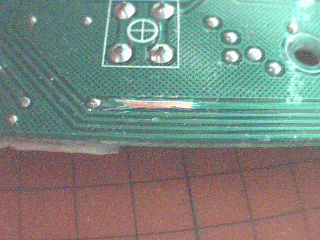

Step 2: Pick and Scrape!
Now pick the area you want to solder to and scrape! You'll notice that you can't solder directly onto the trace. There is a small layer of plastic coating and the polymer solder resist (the green stuff) covering the traces of copper. Our goal here is to remove all the junk so we can get to something that solder will attach to, copper!
Step 3: Prepare!
Now before you solder anything onto the PCB, you need to prepare your components/wires. You should put a dab of solder on your wire or component using flux and cover the revealed copper trace with solder. If you don't have flux, you can still coat your wire (braided wire usually works best). This will make things much easier.
Step 4: Solder!
Now go ahead and solder your component/wire to the PCB.
Hint: If your soldering to a very thin trace, you might want to add a dab of hot glue to keep the component in place
(I used a particularly large trace for the example.)
Step 5: Examples!
The ability to solder to traces can be quite useful in repairs and modifications. In the pictures you can see that I "repaired" a broken trace and added a component to a trace.
