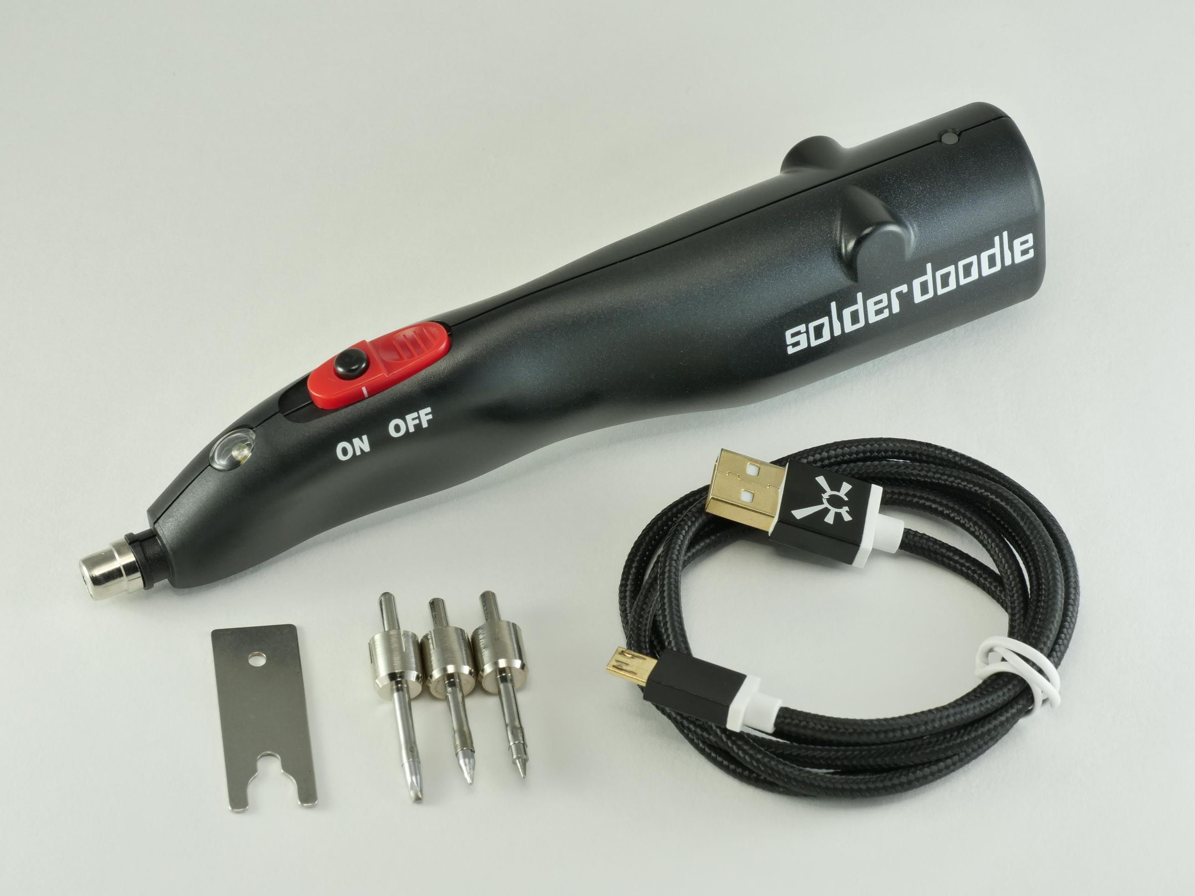

Solderdoodle Pro is a portable, cordless, USB rechargeable soldering iron. It is based off my original Open Source project: "Solar Powered Soldering Station" https://www.instructables.com/id/Solar-Powered-Sol...

Solderdoodle Pro Specs:
Solderdoodle Specs:
* Time to Fully Charge Solderdoodle @ 5V 1A: 3 hours
* Capacity: 3350mAh/3.6V * Type: NCR18650B Lithium-Ion
* Diameter: 1.5 inches * Length: 7.2 inches
* Charge Cable Length: 5 feet * Weight: 96g (3.4 oz)
* Input Cable - Male USB 2.0 Type A to Micro Connector
* Input - Current: 450 to 1300mA | Voltage: 5 to 6 Volts
* Output - Current: 1400mA | Voltage: 2.5 to 4.2 Volts
* Body Material: High Temperature Plastic
* Battery Life Under Typical Use: 5 years
* Replaceable battery * Provides over an hour of soldering
* Solder up to 24 gage thick wire (Flux recommended for lead-free applications, thicker wire, or large ground planes)
* Heats up to over 700ºF (371ºC) in just 30 seconds
* For use with leaded solder and lead-free solder
*WARNING: Be careful when handling any Lithium-Ion battery because shorting the battery can cause burns. Always wear safety goggles. Please use recommended battery and circuit components because of the higher 2000mA max battery charge current involved. 3D printed parts may warp under high temperatures.
