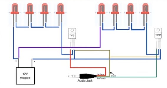

Step 2: Scheme for the Schematic
Now get your LED's and scrape the tip of their heads to make it look more opaque,
now bend their feet and with the wires insert the heat shrink tubing,
now connect the feet of the led and the wires by twisting them both,
now insert in place the tubing and heat it all up with a lighter,
Now this is the key for this solderless project, all it takes is some heat shrink tubing and a heat source,
now follow the design schematic, and now your finish with the circuit.
