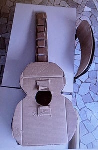

Step 1: Planning
We started by making a cardboard model to see which measurements would be fine to make the guitar quite realistic.

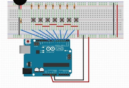

Step 2: Start Programming
We started to build a primitive version of the arduino, with only one laser connected to 7 keys and a buzzer.
We connected the 7 keys with jumpers and put 7 resistors from 20k.
