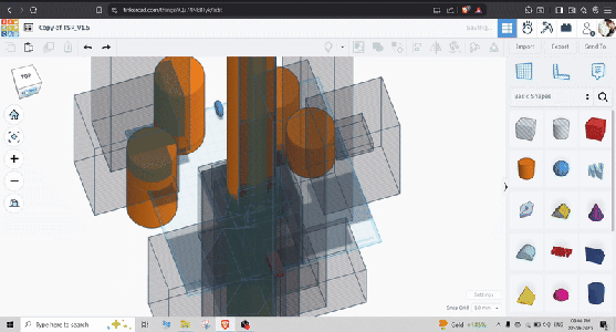

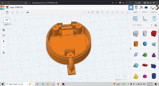

Step 1: Designing the Custom Back Cover in Tinkercad
I designed a 3D-printed back cover for this project that fits perfectly with the CNC metal case. The design was created in Tinkercad, an easy-to-use online 3D design tool.
The back cover is made in such a way that the battery can snap-fit inside without the need for screws or glue. In the same way, I created a slot for the mini slide switch, so it can easily slide into place and stay secure, again with no extra mounting required. Finally, the back cover attaches to the CNC case using the original screws that come with the case, making the whole assembly neat and reliable.
STL with support : https://www.tinkercad.com/things/iuLhoR2B9iq-soulcage-with-support
STL without support : https://www.tinkercad.com/things/izTjHNzJxj2-soulcage-without-support

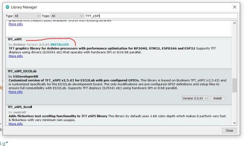

Step 4: Setting Up the TFT_eSPI Library
To run the graphics on the round LCD screen, we need the TFT_eSPI library. This library is designed to drive many different displays, so we must configure it properly to work with the Waveshare ESP32-S3 Round Display (No Touch). Follow the steps below to install and set it up.
1. Installing the Library
  1. Open Arduino IDE.
  2. Go to Sketch > Include Library > Manage Libraries.
  3. In the Library Manager, search for TFT_eSPI.
  4. Install TFT_eSPI by Bodmer (version v2.5.43 is recommended).

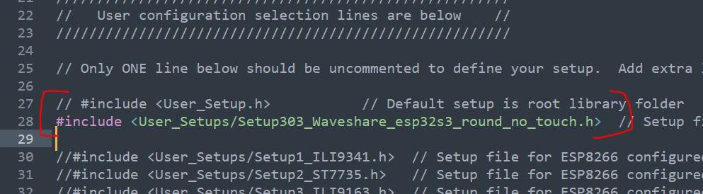

2. Setting Up the Library
  1. Open your computer’s Arduino Libraries folder (usually located in Documents > Arduino > Libraries).
  2. Find the folder named TFT_eSPI and open it.
  3. Download the User Setup file from my GitHub repository.
  4. Copy and paste this file into the User_Setups folder inside TFT_eSPI.
  5. Now, open the file User_Setup_Select.h (you can use Notepad or any text editor).
  6. Look for the line and comment it out by adding // at the beginning.
#include <User_Setup.h>
  1. Add the following line instead:
#include <User_Setups/Setup303_Waveshare_esp32s3_round_no_touch.h>
That’s it! Now the library will use our custom setup file for pin configuration, and your display will work correctly with the SoulCage project.

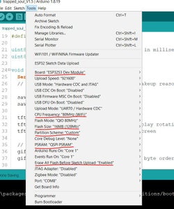

Step 5: Programming the Device in Arduino IDE
Now that the library is configured, we will program the device. This step verifies that all of our previous setup is correct and that the SoulCage display works as expected. Follow the instructions below carefully:
  1. Make sure your ESP32 Board Package in Arduino IDE is installed and updated to version 3.3.0.
  2. Download the SoulCage code from my GitHub and open the project in Arduino IDE.
  3. Go to the Tools menu and set the following options:
  4. Board: ESP32S3 Dev Module
  5. CPU Frequency: 80 MHz
  6. Flash Size: 16 MB
  7. Partition Scheme: Custom
  8. PSRAM: QSPI PSRAM
  9. Erase All Flash Before Sketch Upload: Enable
  10. Connect the device to your computer using a Type-C USB cable.
  11. Select the correct COM port for the device in Arduino IDE.
  12. Click the Upload button to program the ESP32-S3.
  13. If everything is correct, the code will compile and upload successfully. After a few seconds, check the round display: the trapped soul animation should appear, confirming that your configuration and code are working.
Github : https://github.com/vishalsoniindia/SoulCage---The-Digital-Trapped-Soul-Pendant

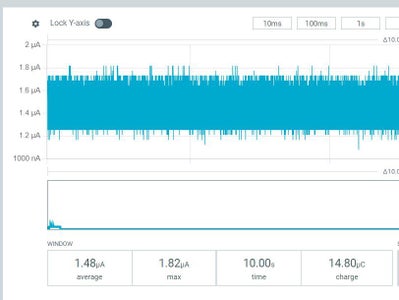

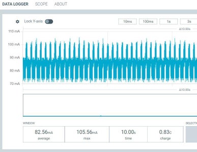

Step 11: Current Test & Battery Life Prediction
To estimate how long the battery will last, I tested the device in two different states and used the Digi-Key Battery Life Calculator for predictions.
  1. Turned Off Condition:
  2. When the device is powered off, it draws only about 1 µA of current.
  3. At this rate, the battery life is theoretically around 108 years! Of course, this is more of an ideal number, but it shows that the device uses almost no power when off.
  4. Turned On Condition:
  5. While the device is running and the display is active, it draws approximately 85 mA.
  6. Based on this current, the battery can last about 11 hours on a full charge.
This means that after fully charging the battery, the pendant can be used comfortably all day without worrying about recharging. The combination of low standby current and moderate active current makes it very efficient for wearable use.
