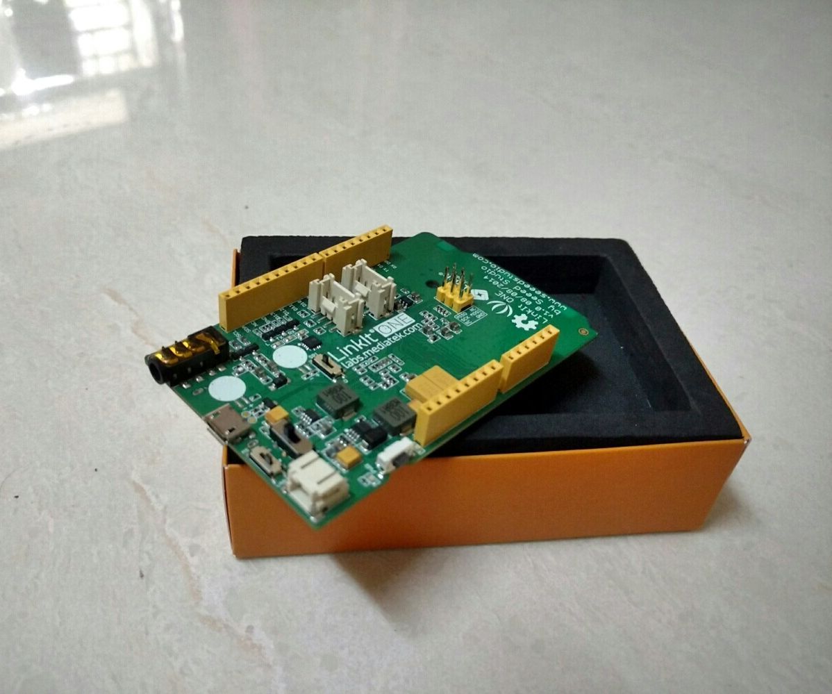

Step 1: What You Will Need?
  1. MediaTek LinkIt One
  2. Sound Sensor ( I shall be using the Grove Sound Sensor here!)
  3. LED (optional, we can use the 13th digital pin!)
Step 2: Assembly
Assembly for this project is pretty simple.
Connect the Sound sensor to the Grove ports or using the shield.
If you have the analog sensors, connect them using the Analog pins directly.
Connect the LED +ve to 13th digital pin and -ve to GND.
That's it! Pretty easy, right?
