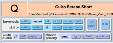

Step 6: Placing Samples Into Soundplant
Okay here is the fun part! We are going to bring in prepared samples into the Soundplant software to start to layout our KEYMAP. This KEYMAP is what we will load to make sure all the samples are loaded each time we open the software.
Since our code was set up to work on only the keys determined in the const char KEY_MAP[12] constant, we are going to start with the letter 'Q.'
You can simply drag and drop the samples into the Soundplant, directly onto the key of your choice. For this examples, we're using 'Q' to start.
When you drag the sample into Q, you will see it becomes highlighted with a purple glow around the key. This is important to notice because we will be applying certain settings to each key so we want to make sure we have the correct one highlighted.
Under the 'KEYMODE' area we are going the select 'restart' instead of 'sustain.' Placing this in restart mode will restart the sample and only play ONE instance of the sample. In Sustain mode, every keystroke will add another instance of the sample to the playlist on the far right side of the Soundplant window. Setting this to restart will help keep processing load down on your computers CPU.
Once you have set up your first sample to these settings above, just rinse and repeat for the rest of your 23 samples!
