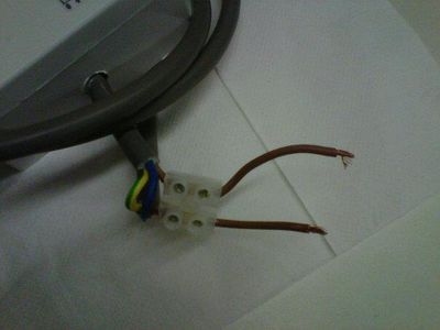

AC Power Control
1. Wire the AC plug to the AC Face Plate with the live pin as shown
2. The live pin will then be connected to the SSR

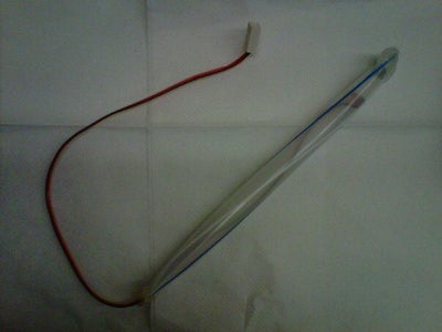

3. Waterproof LM35 temperature sensor
    - Place the LM35 temperature into a straw
    - Seal the both end of the straw
