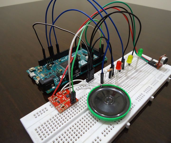

Introduction: Speech Recognition With BitVoicer and Arduino
The main goal of this project was to test the speech recognition performance of BitVoicer (http://www.bitsophia.com/BitVoicer.aspx). For this purpose, I designed a simple led control sketch which I integrated with BitVoicer. Of course you can do anything you want once you have received the commands from Bitvoicer, but to keep things simple, I thought a led test would do just fine.
Here is the YouTube video with the results:
This is the Arduino sketch that controls the leds and retrieves data sent from BitVoicer:

This sketch uses the BitVoicer Arduino Library that can be downloaded from their website: www.bitsophia.com.
The BitVoicer Voice Schema that recognizes the speech shown in the video is available at: http://www.justbuss.xpg.com.br/BitVoicerTest.zip (you need to have BitVoicer installed in order to open it).
