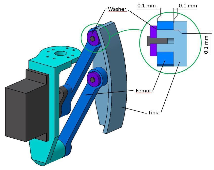

- Design
There are several possible concepts for the legs. Due to little space available in the retracted area (Inside the body) the solution with 2 servomotors by leg was preferred. One for the forward & backward motions and one for the up & down motions.
To compensate for the missing third servomotor (the “classic” quadruped has three servo per leg, Hip, Knee, Ankle) and to ensure the lifting motion of the robot without legs sliding, a parallelogram kinematic motion was added to the up & down servomotors i.e. two functionalities with one servomotor, the up & down motion and the legs parallelism.
In order to optimize the space, the tibia structure is part of the head shape in a retracted position.

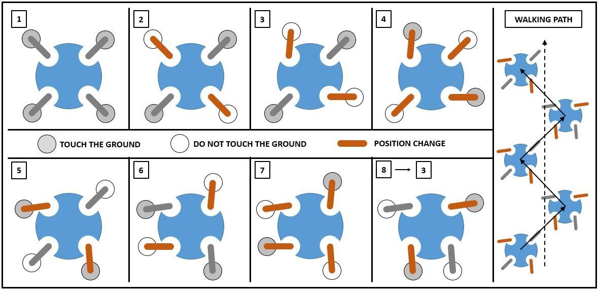

- Walk
There are several walking patterns, one leg after another, two opposite legs at the same time, four legs at the same time and several parameters like the motion amplitude & the movement speed. Conclusion : many possibilities.
This Instructable describes only one solution (it is up to you to explore others), two opposite legs at the same time. The walking diagram can be seen below.
The legs motion are not complex, there are no transformation matrices. Constant variables impose the position of each servomotors.
Special attention must be paid to the legs sliding effect, good friction between the legs and the ground is essential to ensure regular walking. To minimize this phenomenon some anti-slip pads were added on legs bases.

- For the legs articulations, the functional gaps are 0.1mm axially & 0.1mm radially. You could obtain these values directly with the FDM 3D printers. You may need to update them depending on your own 3D printer performance/accuracy.
