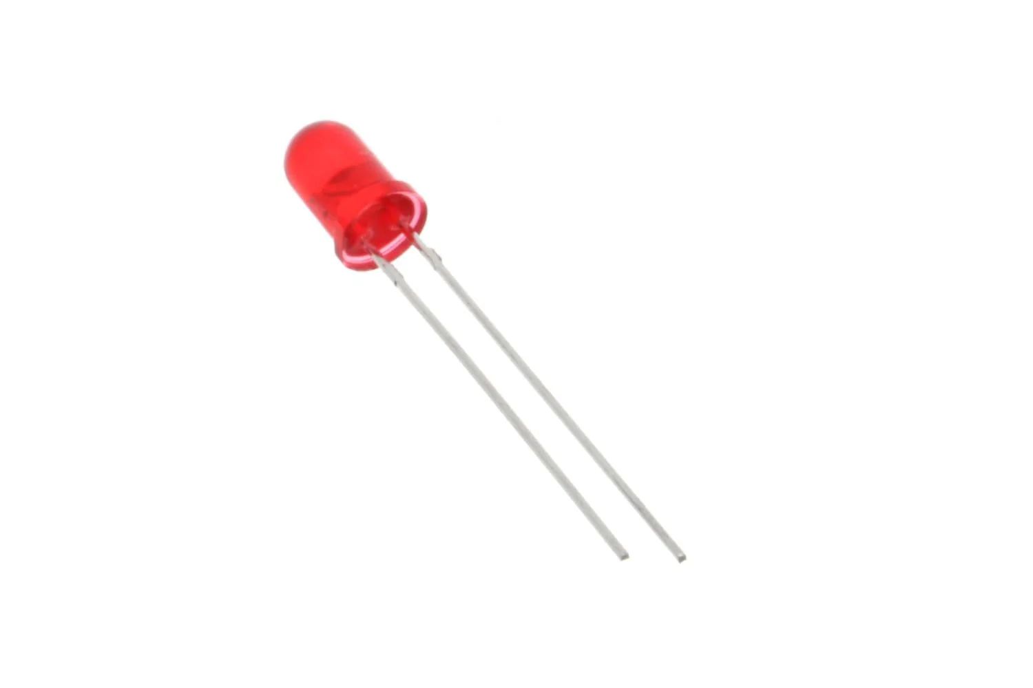

We are going to connect the LEDS, each at a port, 8 and 9.

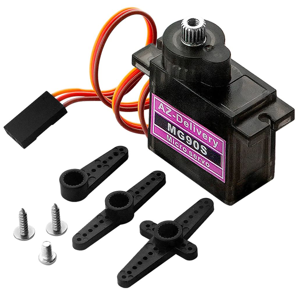

The servo motor is connected in port number 5.

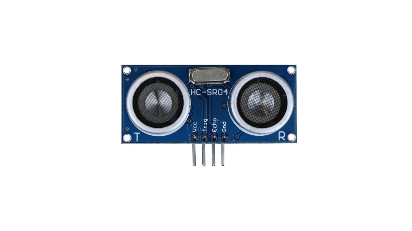

The ultrasonic sensor, the Trigger is connected to port number 2 and the Echo at port number 3.
