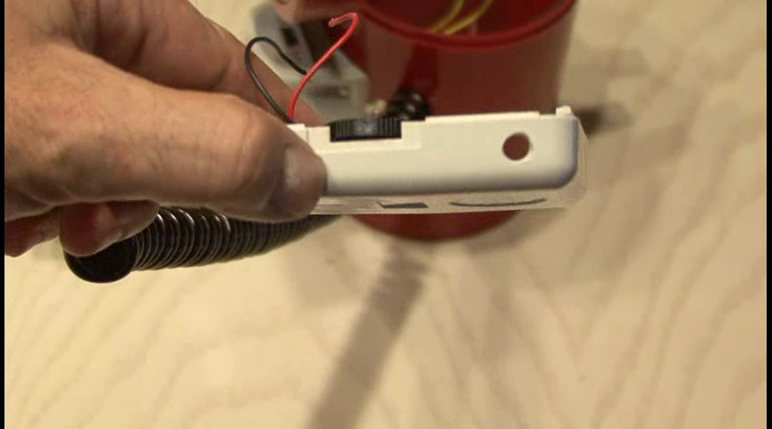

Step 2: Modify the Microphone
1. Remove the two screws that hold the microphone case together and unsnap the case.
2. Using a sharpie, make a mark on the microphone's black wire. That's the Negative (-) connection. Also, if you look closely you can identify the Negative connection by observing the traces that go to the microphone case.
3. The microphone should pull out from the case insert. Put it in a safe place.
4. Drill a small hole in the side of the bottom microphone case to fit the 1/8" audio jack.
5. Solder the red (+) and black (-) wires to the positive (+) and negataive (-) contacts on the audio jack.
6. Install the jack in the case and close the case, reassembling it with the screws.
