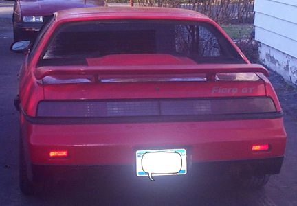

A similar problem with my Fiero except by the time I got that car I had already made the first electronic version of the Cougar blinker. It was easy to add code and another Mosfet to handle the extra lamp.

These also work well on the front signal lights even if yours only have two bulbs. Just populate the board with only one lamp driver. I made individual boards with 1, 2 and 3 mosfets. I even made an 8 mosfet board to do a very annoying cylon effect on a traffic advisor stick.
