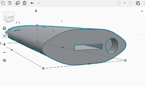

I ordered the letter opener first and when I got it, I measured it and drew out an outline on paper. Added 0.5mm border around it and scanned it to my computer. Then, the image was converted to an SVG file and uploaded to Tinkercad, so I could cut appropriate openings in the dagger later.

Step 2: 3D Files
Download the STL files from my Tinkercad account and print them in the best quality possible.
You can adjust the objects to an extend, to fit your needs. For example, if you get a letter opener that's a little bit different than the one I used, you will have to adjust the files.

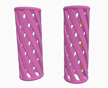

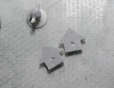

NOTE: There are two lattice handles provided- one plain and one with (orange) horizontal supports- they are identical, so choose whichever one you want. I was having issues with my nozzle, it kept bumping into the lattice- it is a very fragile object until the top rim is printed. Supports are very thin and can be cut off easily with a box cutter afterwards.
Print the objects as shown, don't change the orientation.

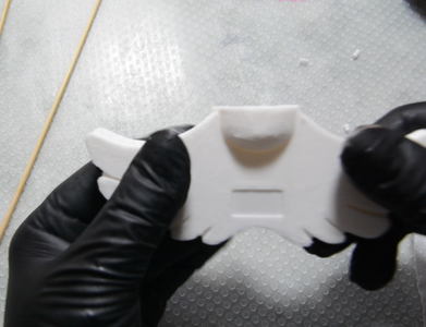

The wings are the most labour intensive, so we will start with them:

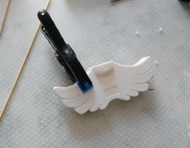

  1. After removing supports, join the wings together temporarily and hold them together with a small clamp. Insert the letter opener and check if everything fits properly.

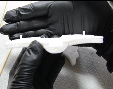

  2. Prepare small dowels, we will use them to align the wings perfectly - you can use toothpicks, bamboo skewers, soft metal wire or cotton buds. They are not meant to be structurally sound, just help you align and stop the parts from moving around while the glue dries.
  3. Mix a small amount of epoxy and apply to the inside of one of the wings. Add some glue to the small holes as well and place the dowels inside. Make sure the glue isn't overflowing into the empty spaces where the letter opener is supposed to go.
  4. Join the wings together using the dowels as a guide and clamp them in several places.
  5. Leave to dry.

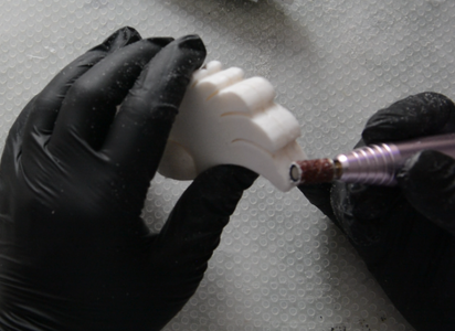

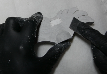

Step 5: Sanding/Smoothing + Some Advice
I used sanding paper/emery boards in 120/240/360/ grit and in later stage 600 grit for smoothing.
This step is just sanding, which doesn't really have to be explained. Keep sanding until your surfaces are smooth, start with lower grit and keep going until you hit 600.

~ use nail file boards- the type specifically made for false nails, as they:
  1. are padded, but have a stiff centre- they can handle a curve and are good for flat surfaces
  2. are easier to hold
  3. have two sides - each side different grit
  4. they can be cut up into smaller pieces
  5. they can be cleaned with a stiff brush, washed and left to dry and used again- more economical than sanding paper
~ instead of Dremel, use electric nail drill (here's mine, I picked it up on sale for £15- good for pedicures and sanding things like PLA, polymer clay, epoxy resin, clay, plaster etc. Just make sure it's powerful enough, around 35 000RPM and definitely NOT cordless):
  1. much cheaper than Dremel
  2. attachment replacements are cheaper too
  3. smaller handle= better grip - good for people with small hands or with hand issues
  4. vibrations are minimal, better control over the device= better results
  5. more settings on the speed dial- better control over speed

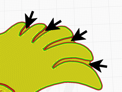

I went and started painting before I realised I made a blunder, so here it is- learn from my mistakes.
The spots arrows indicate are very small gaps in the design, too small to sand in any way, but large enough to see through, especially after paint was applied. It looks very unattractive and gives this "unfinished" feeling, especially since every other part of the dagger is smooth and nearly perfect.
Since this part can't be sanded, filler can't be used either. The only thing that can be used is epoxy to smooth the visible lines.
Here's how to do it:
~ grab a sheet of aluminium foil, scrunch it to make a fist-size bowl and spray a small amount of teal spray paint onto the foil
~ mix a tiny amount of epoxy glue
~ gather a few drops of that teal spray paint and mix it in with epoxy to colour it
~ working quickly, rub a drop-size amount of epoxy into each gap, push it in and smooth over with a toothpick or a fine needle, or a very fine, tiny paint brush
~do it on one side first, leave to set and repeat this process on the second side of the wings
It's such a small, silly detail, but it really makes all the difference. Believe me, I spray painted everything before I realised and I had to scrape everything down and start from the beginning, it was THAT ugly.

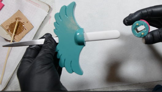

Step 9: Assembly
I made some mistakes at first and there aren't many pictures because I had to work fast, so I will just explain how to connect them.
1) Turn on the hot glue gun and leave it to heat up.
2) Thread the letter opener through the wings and hold on to the blade part tightly. While you are holding it steady, use your other hand to pour some hot glue into the opening to seal the letter opener handle to the inside of the wings. Don't use too much glue and don't let it escape outside.
2) Once hot glue sets, you can put the wings down.
3) Mix a small amount of epoxy and apply to the top of the dagger handle. Do you see these small holes I made for the small alignment dowels? They are redundant, no need to use them. The handle and wings will align together through the letter opener handle.
4) Connect two pieces together and press together tightly. While you are holding it with one hand (you can ask someone to help you with this part), pick up your glue gun and squeeze some hot glue into the hole at the base of the dagger handle. It will secure everything together faster.
