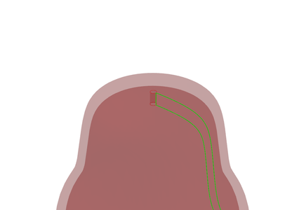

1. Outline the exterior and interior of the doll with two curves, and align all four ending vertices along with the Z axis
2. Draw a short line (straight curve) to connect the two ending vertices at one side of the doll.

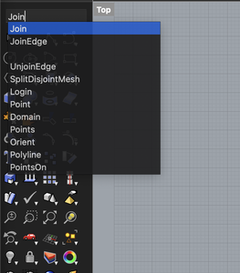

3. Join twice to combine all three pieces of curves into one curve for the following revolving
Step 5: Fixed Invalid Brep Object Error
Lesson learning: the curve should be OPEN, otherwise there is the "invalid Breb object" error. By moving the up side a little bit off the Z axis, this error is fixed, though it leaves a whole on the top of the model.
