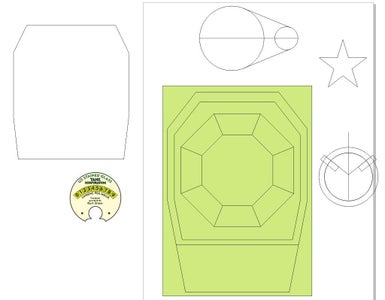

A good design is a must if the end result needs to look good. That being said, a project like this could be built without any preliminary design work. I started with a few basic parts designed on the computer and printed them up for templates. As the tank progressed, there was less designing and more on the fly part building. There are 100's of ways to design a project like this.
