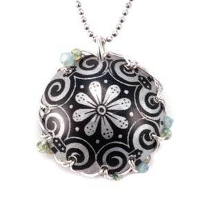

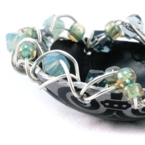

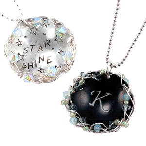

This simple FREE class makes stamped pendants really special. Instructor Kate Richbourg shows a quick embellishing technique using free-form wire wrapping and crystals to create a fancy rim on a stamped and dapped metal blank. This design is adaptable to different metal and beads offering a variety of design options.
