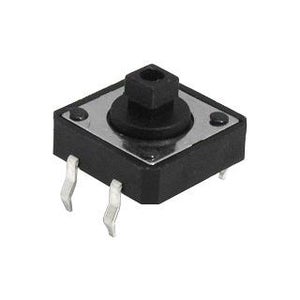

  7. 20 - 12 mm x 12 mm 4-pin Tactile Switch SPST. Digi-Key. (Pictured above. Note the square shaft.)

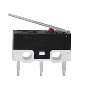

  11. 1 - 12.6 mm x 5.7 mm x 6.5 mm Micro Switch SPDT. Amazon. (Pictured above.)

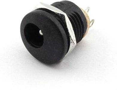

  12. 1 - 5.5mm x 2.1mm 3 Pin Female DC Power Jack Panel Mount. Amazon. (Pictured above.)

Populate the Keypad PCB with the diodes, switches, and a single 90 degree header mounted below the PCB.

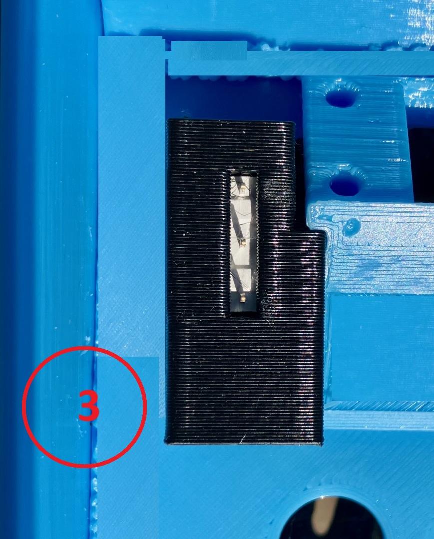

Step 6: Mount the Power Switch
  1. The Power Switch is made up of three parts: The Switch Holder, Switch Slider, and the Micro Switch itself.
  2. Assemble the three parts as seen in this image. Pay Attention. There is only one way the parts go together like this. No glue required.
  3. Once assembled the power switch is glued to the underside of the Top Panel beside the Small Display Mount as pictured here.

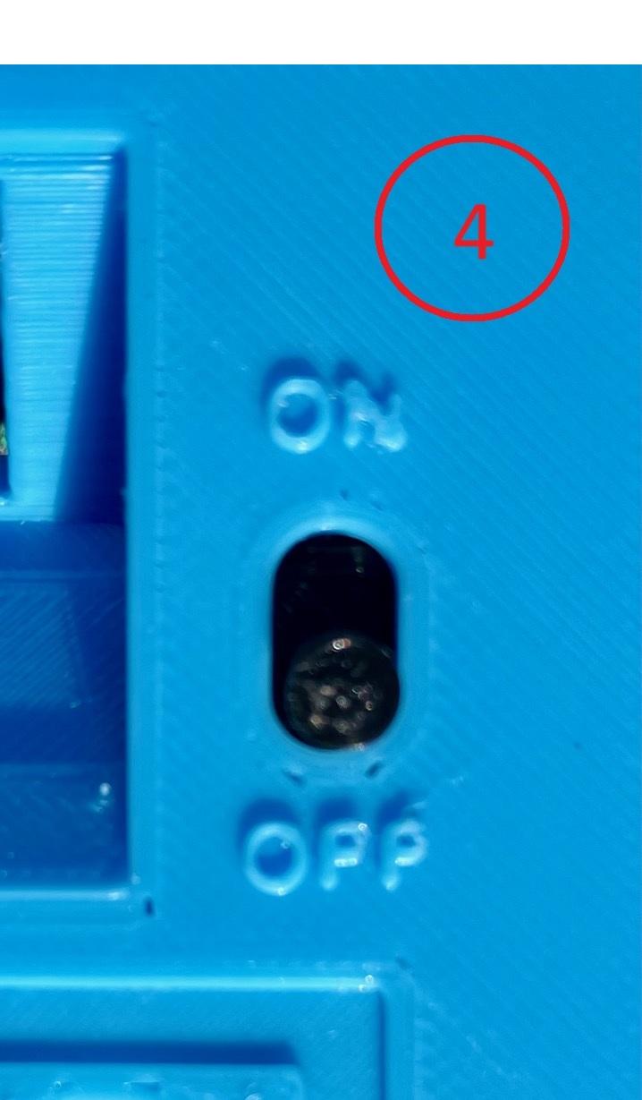

  4. This is what the upper side of the Top Panel should look like when the Power Switch is installed.

  4. Mount the DC Power Jack onto the hole in the back of the Case Top.
  5. Solder one jumper wire with a female header to the center pin of the Power Jack and attach it to the +5V pin on the CPU PCB. (Remember that in this version of the PCB the power labels are incorrectly reversed.) Solder a wire between the GND pin on the Power Jack and the center pin on the Power Switch. Solder a jumper wire with a female header to the bottom most pin of the Power Switch and attach it to the GND pin on the CPU PCB. Double check that the power is going to the proper pins.
