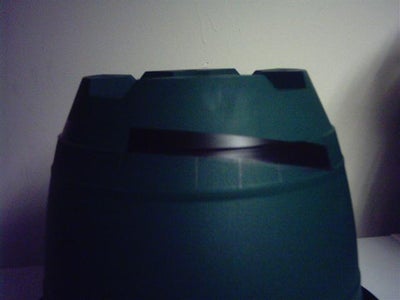

Step 1:
Start with the 12-inch planter. Get the kind that has the detachable base.

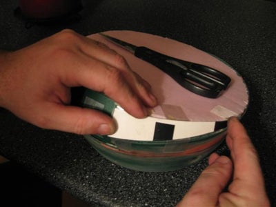

Step 2:
Rather than try to sketch the lines all the way around the pot, I use tape to lay the basic
shape out .
Step 3:
Cut the basic shape from the planter with the base detached.

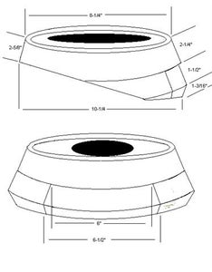

Step 4:
These are the measurements for the cutout in the back.

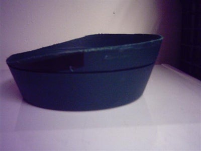

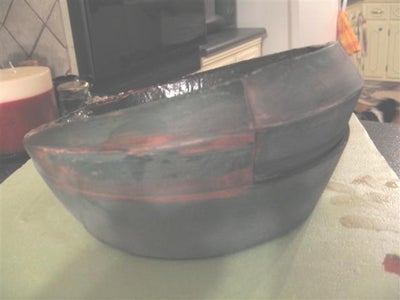

Iíve skipped several steps here. Remove the base. Cut an oval out of the base and set
aside. Cut the bottom 1 to 1-1/2 inches from the planter then glue the two pieces together
with liquid nails. Clamp the pieces together and go do something else for 24 hours. When
24 hours have elapsed you may begin filling in the gap between the planter and the base.
In the back, cut a 6- inch wide strip from the planter portion. This will be that depression
in the back. Do not cut into the base portion. From the unused planter leftovers, cut a
piece just large enough to be glued to the inside of the donut. Cutting pieces of
posterboard as patterns to fit will really save time and plastic. When youíve got a piece
that you can live with, liquid nail it and clamp it for 24 hours.

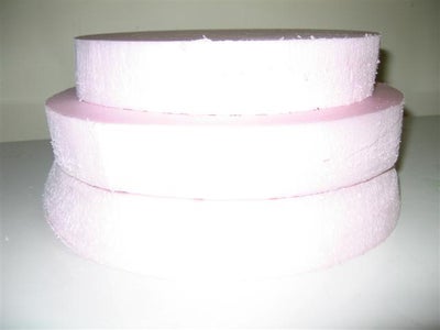

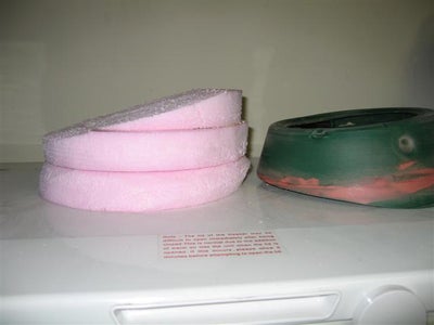

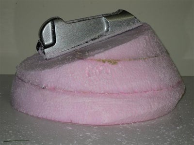

Start on the helmet core. This is an important part because it gives you something to glue
the rest of the plastic to.  Cut 3 pieces of 2-inch styrofoam insulation the width of the donut.
Step 7:
That thing on top is a cheese grater file. This particular one is called a pocket planer. In
about 20 minutes you can shape the foam to look like this. Youíll definitely want that
angle for later. Notice the angle on the bottom?
Step 8:
I used a hand saw to get the angle right.

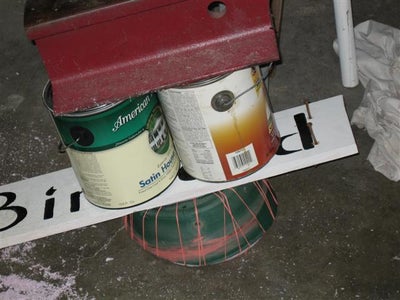

When the foam core fits inside the donut perfectly, put a heavy coat of Liquid Nails
inside the donut shell and put some weight on it.

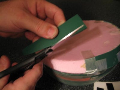

Take pieces of posterboard and begin making templates for the bottom section.
Step 11:
You can cut the plastic with scissors but be warned. The plastic is fairly soft but will
break.

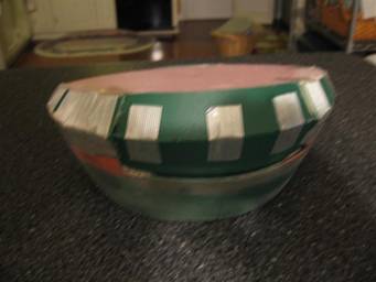

Step 12:
Glue the pieces on with Liquid Nails and tape like crazy!

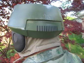

Step 15:

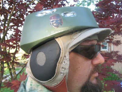

Here it is, the finished product. It was used as a model for a chap that who made vaccuum formed versions of it. It looks good, I
made it myself, and it only cost me about 10 bucks and a buttload of sweat. Let's go burn
some holes in a bunch of Stormies!
