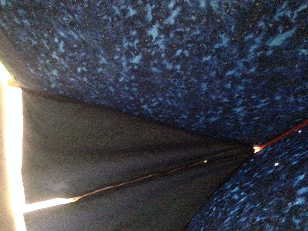

Step 5: Sew Your Lilypad Into the Fabric
Using your embroidery hoop and conductive thread, sew the components of your Lilypad into the large rectangle of your inside-the-tent fabric (the night sky printed one). You can follow the diagram above, or you can come up with a system that works best for you.
When you sew, be sure to keep in mind:
  • Do not allow any of your threads to cross paths because that will cause the circuits to not work.
  • Be sure to sew around each of the petals a few times to make sure that there is a strong connection. (I always sewed three loops around every petal.)
Optional step
I did not want to see the plastic around the LED lights when I was in the tent, so I decided to create small holes for each LED to poke through. I used thread scissors to poke a pin-sized hole, then I used a whip stitch to secure the hole and make it a bit larger. (refer to image above.)
Step 6: Create an Access Point to Your Lilypad

Step 10: Close the Top of the Zippers
Now you should have a gap between the top of your zippers and the top of the tent that is gaping open. To close that gap, fold the tent so that the tops of the triangles lay flat, with the right sides facing each other. Sew along the edge. When unfolded, the top outside of the tent should look like the picture above
Step 11: Sew the Final Two Edges of the Tent
The short edges of the large rectangle should be the only edges left un-sewn. We need to use these edges to create tubes for the wooden dowels to go through. To create these tubes:
1. Fold the edges over to create about 2 inches of overlap. Fold toward the inside of the tent.
2. Pin the fold in place.
3. Sew the tube along the long side, but DO NOT sew the short edges. If you sew the short edges it won't be a tube and your wooden dowels won't be able to go through.
4. I recommend that you sew down the long edge twice for more durability.
Now the the tent is completely finished!
Step 12: Set Up Your Play Tent and Enjoy!
To set up the tent:
1. Fold the tent in half and lay on the ground.
2. Thread the wooden dowels through the bottom tubes and through the opening in the top.
3. Insert the dowels into the holes in the tent poles.
4. Stand the tent up, and then separate the bottom poles so that the tent stands up by itself.
5. Use the ties to secure the tent to the tent poles.
Once it is setup, flip the switch inside the tent and enjoy your indoor starry night sky!
