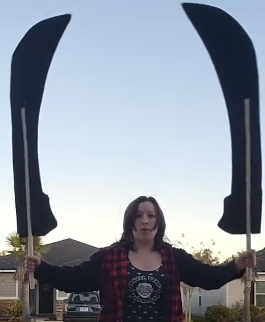

The first step was patterning. The simplest way to pattern armor to your size, is to wrap each limb you want to armor in cling wrap, followed by masking or painters tape. Make sure it is fully covering in the area you want then carefully make a straight cut down the tape and cling wrap to have the perfect shape. Add about half an inch around the edges to allow for wiggle room. I did this for the chest plate, leg armor, and bracers. For the helmet, start with a base head shape you want. I start with a general smooth head shape pattern. Once I had that, I used a paint pen to sketch out where I would be sculpting on details later. For the swords, I printed a scale blueprint to trace onto the foam. For structure, I cut out a center gap to insert PVC pipe into the swords with contact cement. To hide the PVC pipe, I used thin strips of Eva foam to cover it on each side.
