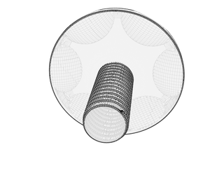

Mounting Bolts (print 2)

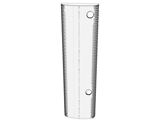

Photo Sensor Mounts (print 2)

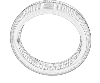

Resized Threaded Round Nuts (print 2)

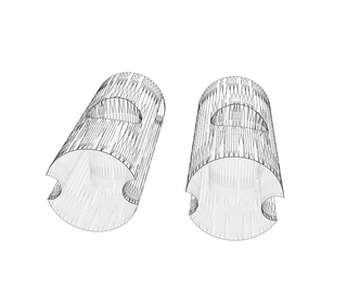

Bottom box of project (goes under outdoor thermometer)
Box Top (goes over top face of thermometer, it is a template for your holes that you will make through the thermometer face, you will toss this part when done or use it later to build additional thermometers)
Cap Spacers (print 2) these are to go over faceplate and under the threaded round nuts when building project.

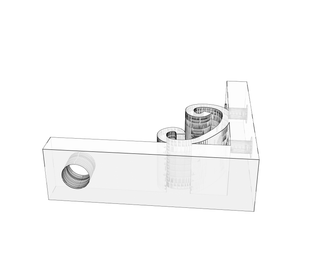

Top Mount
Bottom Mount (this has bottom cuts so you can run a wire through the bottom or you could print two top mounts and flip it when using it as a mount)

Take your photo sensor leads and feed them through the threaded towers in the base of your model f you haven't done this already and solder the photosensors to the leads.
Place your photo resistors over the sensor mounts and pull the sensor along with the mount using the wires that you just pulled through the towers before soldering, and pull the wire along with the mount and the sensor down into the towers.
In the smaller hole above the large hole where you pushed the wires into the tower, secure the mount with a small screw, this will keep the photo resistors from sliding out.

Take the two caps and place them over the two protruding towers, so the larger deeper side faces the right side of the box.
Take the two round nuts and secure the thermometer onto the bottom box.

Take 3d printed Wall mounts and mount only the top mount using a small level and mount to wall.
Take Threaded Mount and mount it to the top of your Box and tighten but not overly.
Get your 2 lasers positioned and aim one at the bottom photo sensor and the top photosensor.
Now take your bottom wall mount and connect it to the bottom of the laser thermometer and then mount it to the wall.

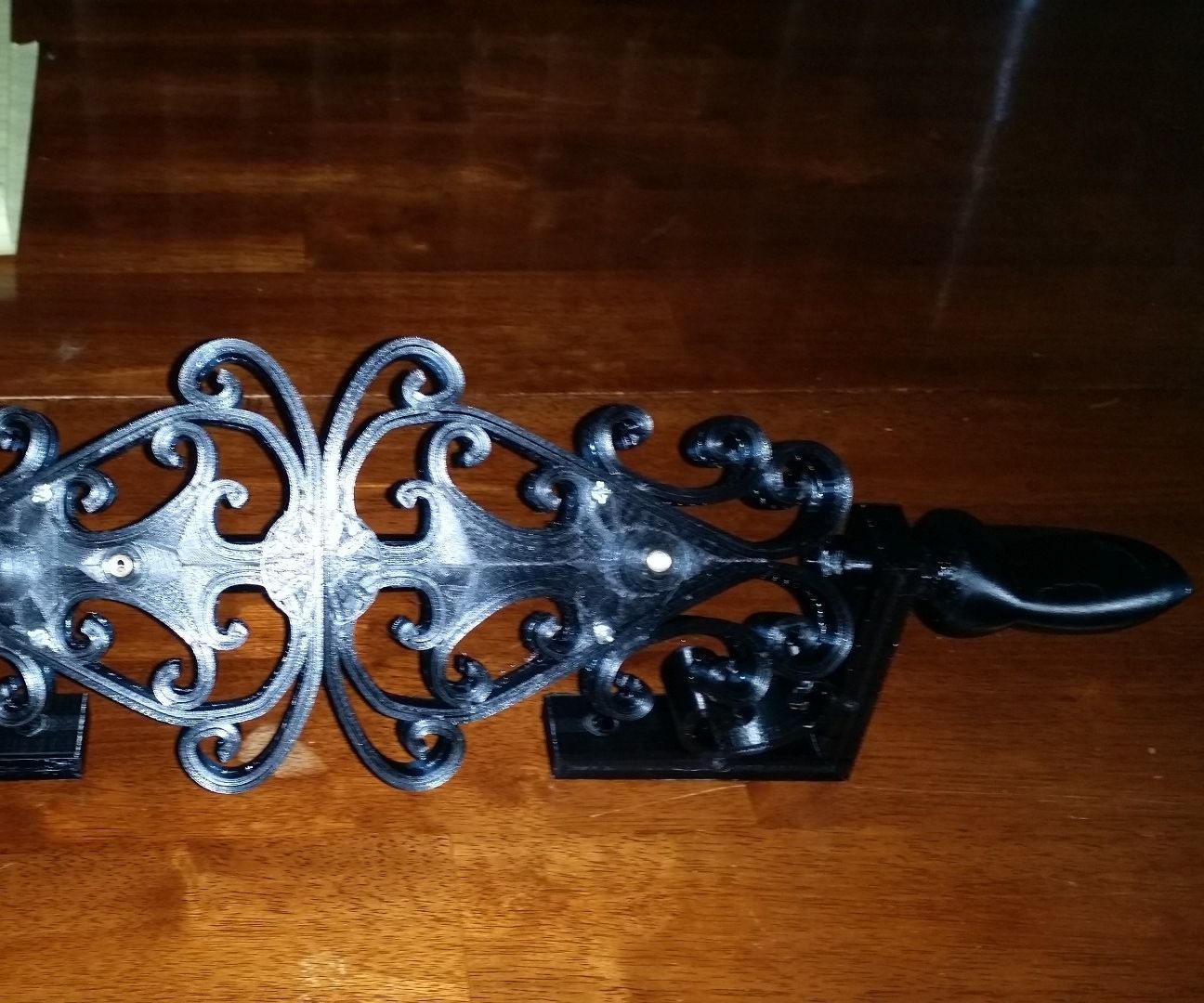

Above are photos of the next project "Stealty Laser Security for 3d printing" using the mounts included with this project.
