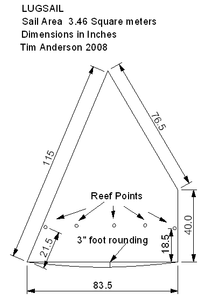

Step 3: Lugsail Dimensions
I originally made this 3.46 sq. meter lugsail for my Klepper Aerius 2 tandem folding kayak.
It was about the right size except when a howling gale was blowing.
I made it from a well-preserved windsurfer sail, which had some broadseaming.
Broadseaming means making the seams between panels a varying width so as to make the sail like a shallow bowl. For more belly, add a bit of edge rounding to the bottom of the head of the sail.
For less belly, cut it straight.

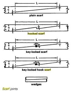

Step 8: Scarf the Tails On
I used a scarf joint to add a few feet of redwood to the tail of the boom.
That saved me the trouble of laminating the full length of the boom and the trouble of finding long wood good enough to do it with.
I used a Japanese pull saw and a knife to cut the scarves.
Next time I'll cut a the easier straight scarf and add a key to keep the halves from slipping.
As seen in this illustration from "The Elements of Boat Strength" P.138
Then I wrapped it with a lashing of innertube. It feels good ans solid.

    12 years ago on Step 3
    Is there any way the sail could be homemade out of trash bags and whatnot, or would that not hold together?
    0
    siggy_lxvi
    siggy_lxvi
    Reply 12 years ago on Step 3
    A: Garbage bags wouldn't hold. Thick canvas or tarp would work. B: what the OP is referring to as "reef points" are actually telltales. They are used to indicate whether airflow over the sail is laminar or chaotic. Reef points are used to reduce sail area, usually in violent storms - the kind of weather in which you wouldn't be using this sort of sail.
    0
    TimAnderson
    TimAnderson
    In the diagram above, the things labeled reef points really are reef points. When using this sail with a kayak you need to reef down in just moderate winds. I failed to do that in Costa Rica in a strong offshore wind and was capsized, blown out to sea, lost my water, and although we both survived, lost the girlfriend too.
    0
    siggy_lxvi
    siggy_lxvi
    My appologies, then. I've never sailed a kayak, just everything from a 15-foot dinghy to a tall ship.
