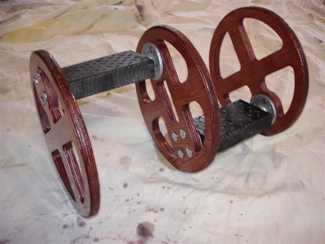

Step 2: Build Pedal Shafts
Materials
(2) Galvanized 1/2" pipe flanges
(2) 1/2" black pipe pieces 8" long
(4) 1/2" black pipe elbows
(2) 1/2" x 3.5" pipe for the offset pieces
(1) 1/2" x 3.5" pipe for the center section.
Build this first to get all the measurements needed for the other parts. Put all the part together as shown in the picture. Tighten them very tight, but make sure everything is squared up and the bolt patterns of the flanges are square. I primarily used black pipe parts because I found some around. To prevent the parts from loosening later, I tack welded them, but I am sure epoxy or JB Weld would do. Measure the offset the pedal shafts have from the center. This will be used for the bolt patterns on the wheels later. Measure the width of the clear areas of the pipes in the pedal area for the widths of the pedals.
Step 3: Build the Wheels
Materials
3/4" Plywood.
Cut (2) 16" diameter circles out of plywood. I used some nice Baltic birch I found. I used my router to add the steampunk details. Drill holes for the flanges with the correct offset from the center as measured in the pedal shaft step. I used t-nuts to bolt the flanges on because I had them. I am sure other fastening methods would work. I also put black t-molding around the wheel. I got it from www.t-molding.com. I borrowed a slitting saw blade to cut the groove. They sell router bits to do it too.

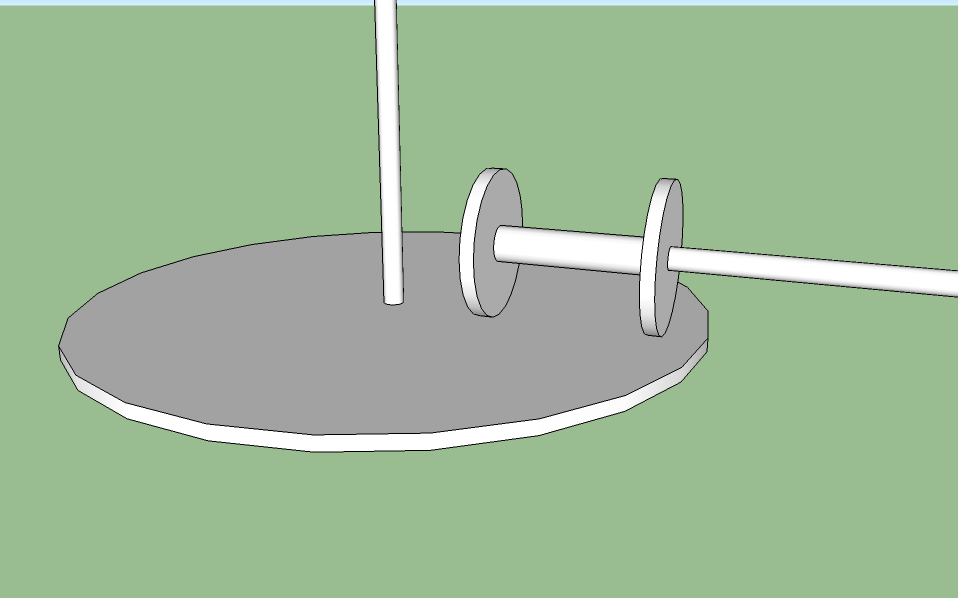

Here is a very rough rendering of what I am working on.
This is a 2 person self balancing cycle. I have seen similar examples of this elsewhere, but mine is on a smaller scale. My goal is to make it very easy to make and cost less than $100.
It self balances because the weight is below the center of the axle. The pedals will connect to the wheels via chain. Each person controls one wheel. Pedal to together and you go straight. Go opposite and you spin in place, etc. I will probably make some form of disc brake for each wheel. Not shown are casters that will contact the ground to prevent rollover on sudden starts or stops. I am going to start at a scale for kids (about 5' tall max).
See the snapshot of the Sketchup drawing of the basic concept.
Here is a link to the Sketchup (Ver 7) file.
