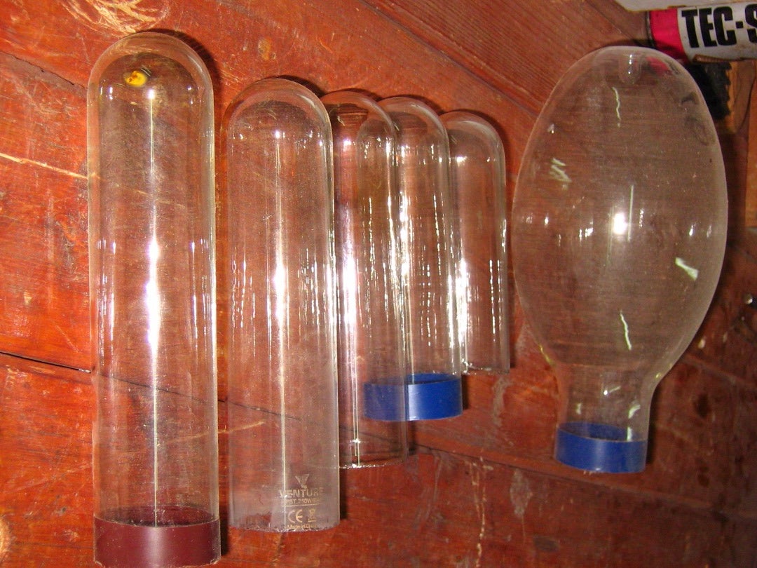

Step 4: Glass Bulbs for the Terrarium..
I went to a big supermarket and spoke to the manager,asking if he would be kind enough to give me the old burnt out light bulbs.He told me that the company that changes the light bulbs take the old ones to throw away.
Luckily it was in the same town,SO gave them a try.Luck was with me,they gave me all their old bulbs.Over 20 of them, some large some smaller and the worker I gave a couple of packs of cigs and my phone number.He phoned me many times and I now have over 60 mixed bulbs at the cost of200 cigs "very cheap LOL"

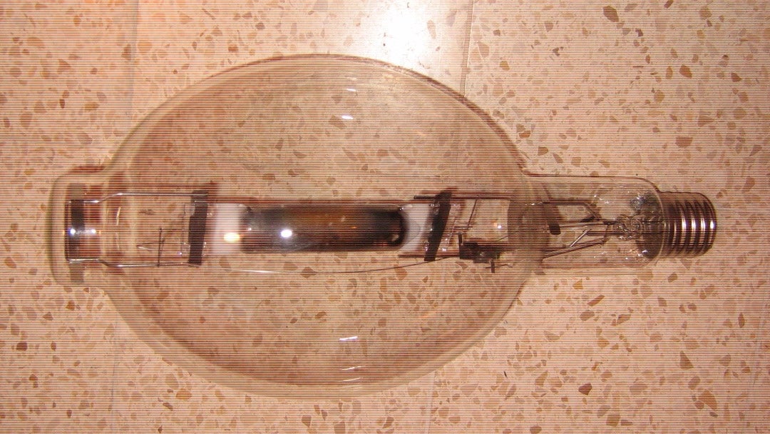

Broke 2 bulbs trying to remove the electic inards the way another "instuctable"showed how."Only thing is."
these had very strong metal parts and could not cut with nose pliers, so cut around the metal thread with a grinder,leaving 3cm,on the bulb and all came out fine.I found out later,it's much easier to cut the glass with an electric diamond disc cutter,takes less than 20 seconds.Spent half hour cutting spare bulbs and now have
30 odd bulbs ready for (hanging terrariums)........AND SO TO THE PLANTING...I did this first so that the plants would get a good growth.Use slow growing plants,GO TO MY INSTUCT"Terrarium in a milk bottle"

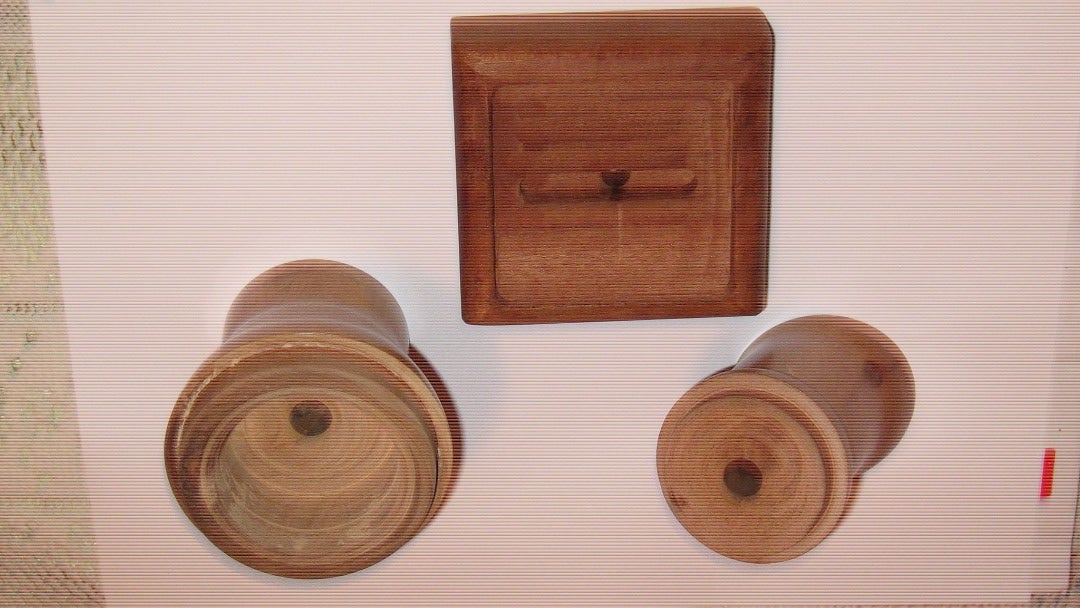

Step 6: All the Wood Pieces That Are Turned on the Lathe.
The first piece (1) on the left Is to hold the bronze inclusion and copper pipe
It is placed on top of the base wood number 4.and with wood glue joined and with the wood screws
from underneath.Holds very good.

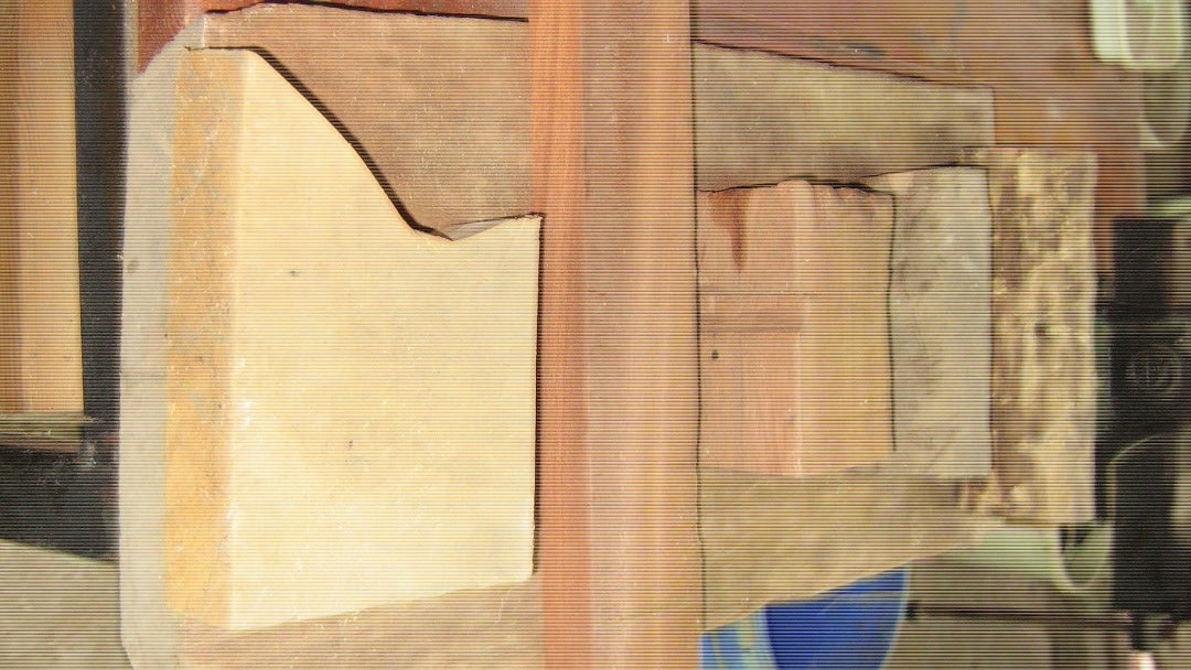

Photo 2 The square piece of wood (teak) has had a indentation carved to embed the solar panel
with a 6mm hole for the wires to go to the batteries..The other 2 pieces hold the electrics and batteries.
placed in hole number 3
The last 4 photo's are for accepting the copper pipe,LED,and the bulb.If you run from photo 3 to 7 you will see how they join up.

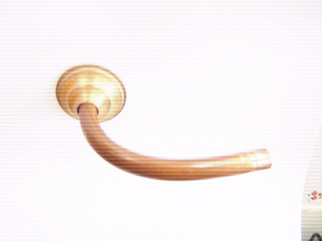

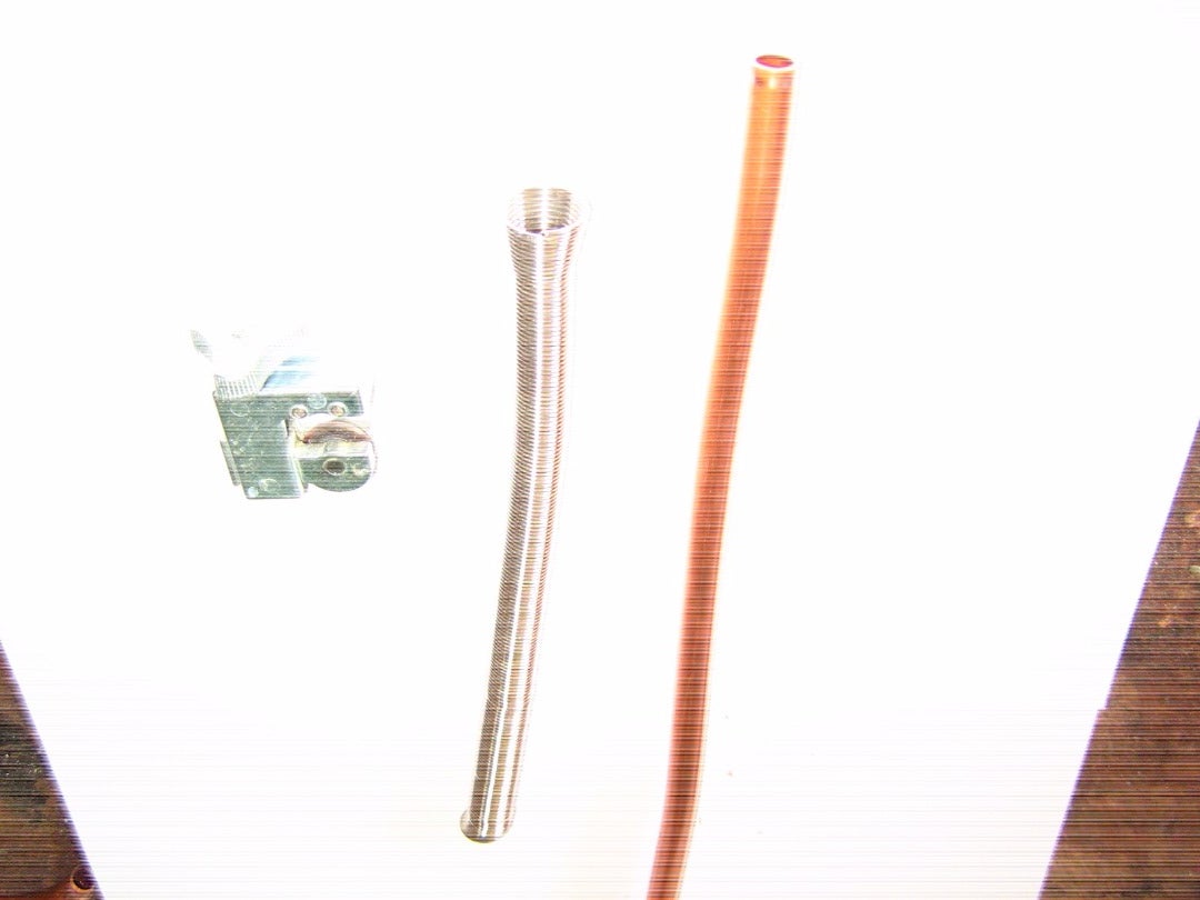

Step 7: Bending the Copper Pipe.
I didn't know how to bend without crimping,(deform) so went to a man that repairs Air conditioners
he told me that there is a special spring to do it.Bought one $5.It was so easy.Be very careful that you
give enough pipe to go into the base,and into the wood that holds the bulb.(Use the copper bending spring)
checking the correct angle that the pipe needs to be.

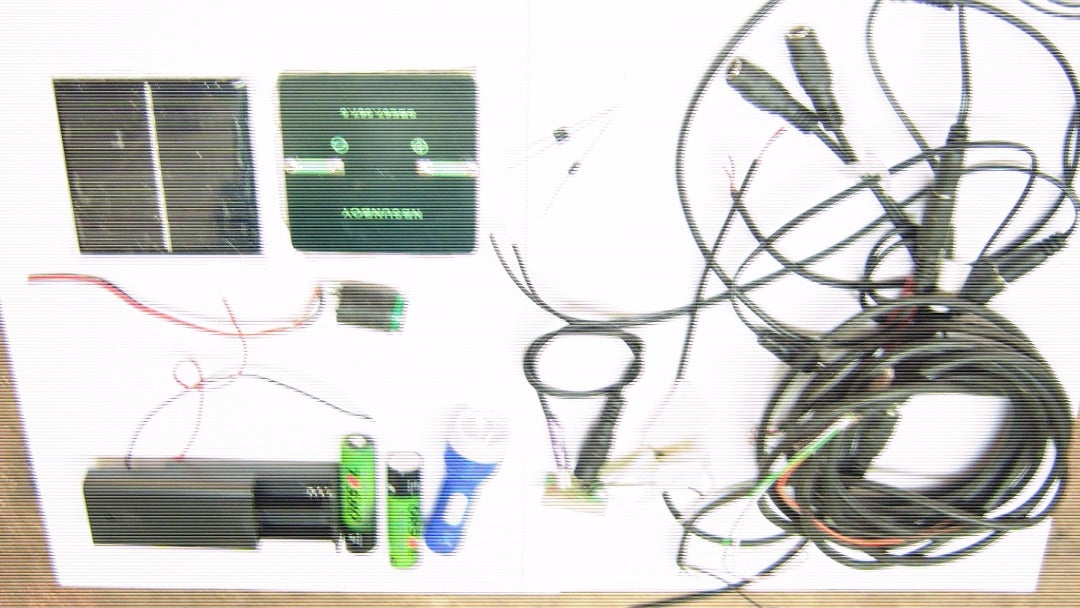

Step 10: The Electrics..
There are 2 ways one can join all the electrics.
1..Battery Minus to Solar minus...Solar + to the diode furtherest from the white ring,White ring end diode to the +battery... From the + battery to switch, from the switch to the+ led from the led minus back to the battery..
2.. I retrieved the electric panel from a garden solar light.Second Picture. on the panel (in very small letters)
b+ and b- = battery... S= solar...L= led... The panel also has a switch TURN IT ON...
I put a number on each of the wires.1=led+ 2=led minus 3=solar panel minus 4=solar panel+
5=batt minus 6=batt + which goes to your switch and then to the + led ..
I used a half $ torch very srong light. took only the bulb holder and reflector casing .
When you have tested that all works,put into place.
