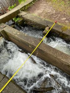

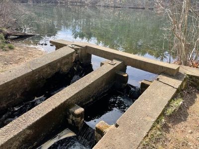

The site I chose is at a nature preserve in Kingston called Stewart-Person Preserve. This location is near my school. There is a real need for a bridge here. There is a nature trail that goes around a small pond. The trail comes to a dangerous stop at a herring run and a water spillway. A person like me would have no difficulty crossing. But, you need to be stable and balanced -- it's like walking on a balance beam. The elderly, small children, or people with limited mobility would have difficulty crossing. My goal is to build a bridge that has two purposes:
1. Provide safe crossing
2. Provide a resting area where people can enjoy nature and fish.
Step 2: My Solution

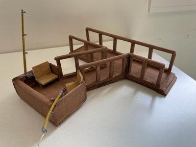

I wanted to design a bridge that sits on the original structure -- the fish ladder and spillway concrete -- because the fish ladder and spillway are necessary, though dangerous. I also wanted to create a section that extends from the main bridge and goes out over the water. The section that goes out over the water has fishing pole holders and a guard rail. I chose pressure treated wood for my design because it can hold up to the elements, it is very easy to work with, and it is a natural material that fits in with the woodland environment.

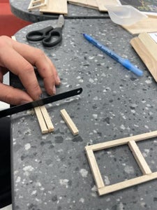

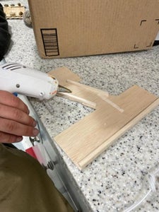

I decided to make a physical model out of balsa wood and hot glue. Here are the steps I completed:
  1. I measured the span that would be needed at the Stewart-Person Preserve fish ladder. The distance needed to cross the existing structure is 25 feet. I decided on a scale of 2.5 feet per inch on my model.

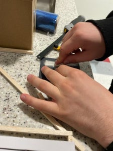

  2. I measured the pieces of balsa wood to make the pieces I needed for my model.
  3. I cut the pieces of balsa wood with a hacksaw. As I continued I found out that scoring the wood with a pen and a ruler produced the best cut.
  4. I glued everything into place.
  5. I sanded everything down to make it nice and smooth. First I used rough grit sand paper then I used fine grit.

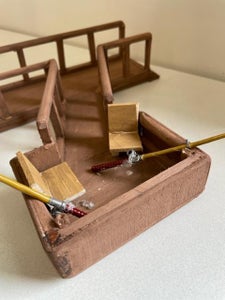

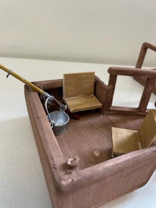

  6. I experimented with different paint colors by mixing multiple shades of brown with water because I wanted it to blend in with the surroundings.
  7. At the end of the project I decided to add in chairs/benches and rod holders for the part of the bridge that extends out over the water.

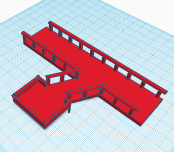

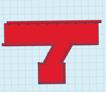

Step 4: Designing in Tinkercad
I find it easier to work with my hands. It is easier for my brain to process. I started thinking about two pieces of wood and how to get something out over the water. I needed to visualize my solution by manipulating materials over each other. I started by overlapping two boards and then saw my design come together. The way my brain works, I needed to physically put it together and build it.
I don't have a lot of experience with Tinkercad. I have a friend who is good at it. He showed me how to build in Tinkercad. I learned how to use the copy and paste feature and the grouping feature to make my design. Most of the shapes I used were made from the rectangle tool. The copy and paste tool saves a lot of time.
Most people start with Tinkercad to create their design, but I worked backwards because I need to use my hands and real materials to visualize my design.

I learned how to work with different materials. I found out I'm pretty good with wood. The balsa wood was a soft and malleable material. I was able to create a well-built physical model that achieved my goals of creating a safe crossing and a place where people can enjoy nature and fish over the water.
