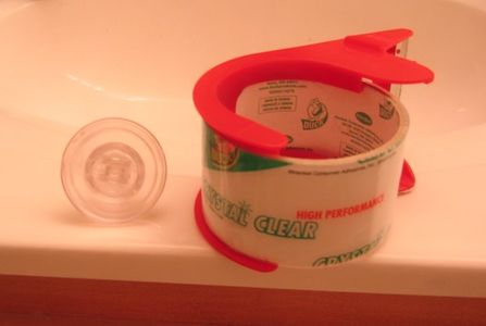

Step 3: Select a Tape
You need a tape that is at least as wide as your suction cup. You might be able to get away with tape only a slight bit narrower, but your mileage may vary on that.
Here I'm using standard-issue packing tape; it's about as wide as this suction cup.

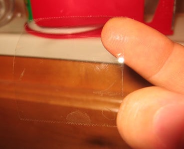

Step 4: Cut the Tape and Stick It
Cut a square of tape and stick it to the wall right in the spot where you want the suction cup.
Use your fingernails to rub the tape into the wall - you want to eliminate air pockets and force the adhesive into all the nooks and crannies of the textured surface so it will hold up under the vacuum pressure from the suction cup.
