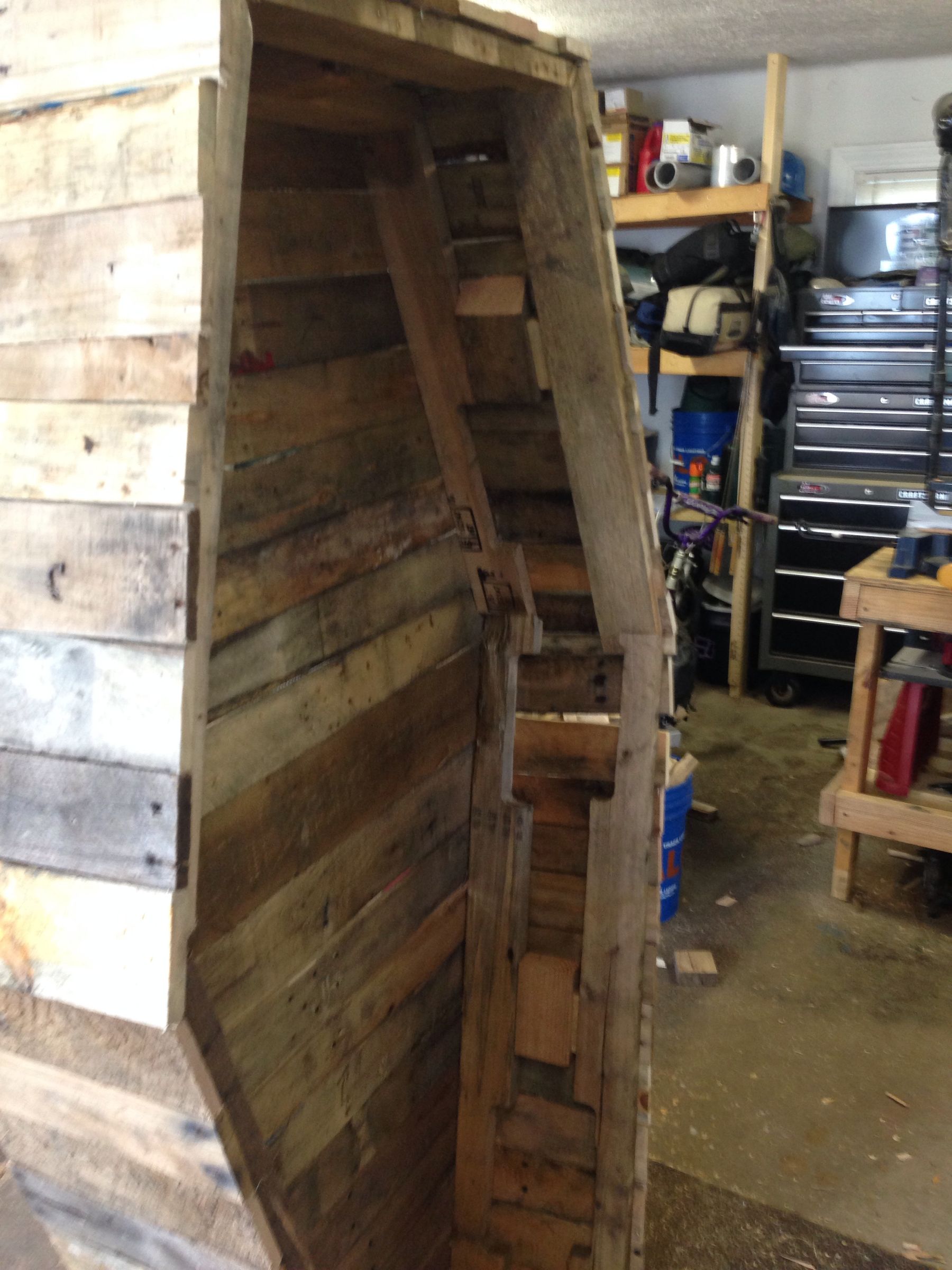

Step 3: Bottom
For the bottom i went over board. I chiseled out to top 2 support boards to fit the stock top part and then drilled holes with a forstner bit for the dowels to go through. More for ascetics. U can skip that and mount it however u want. Same with the base i kinda winged it. As u can see in the pic i added some more accent parts.

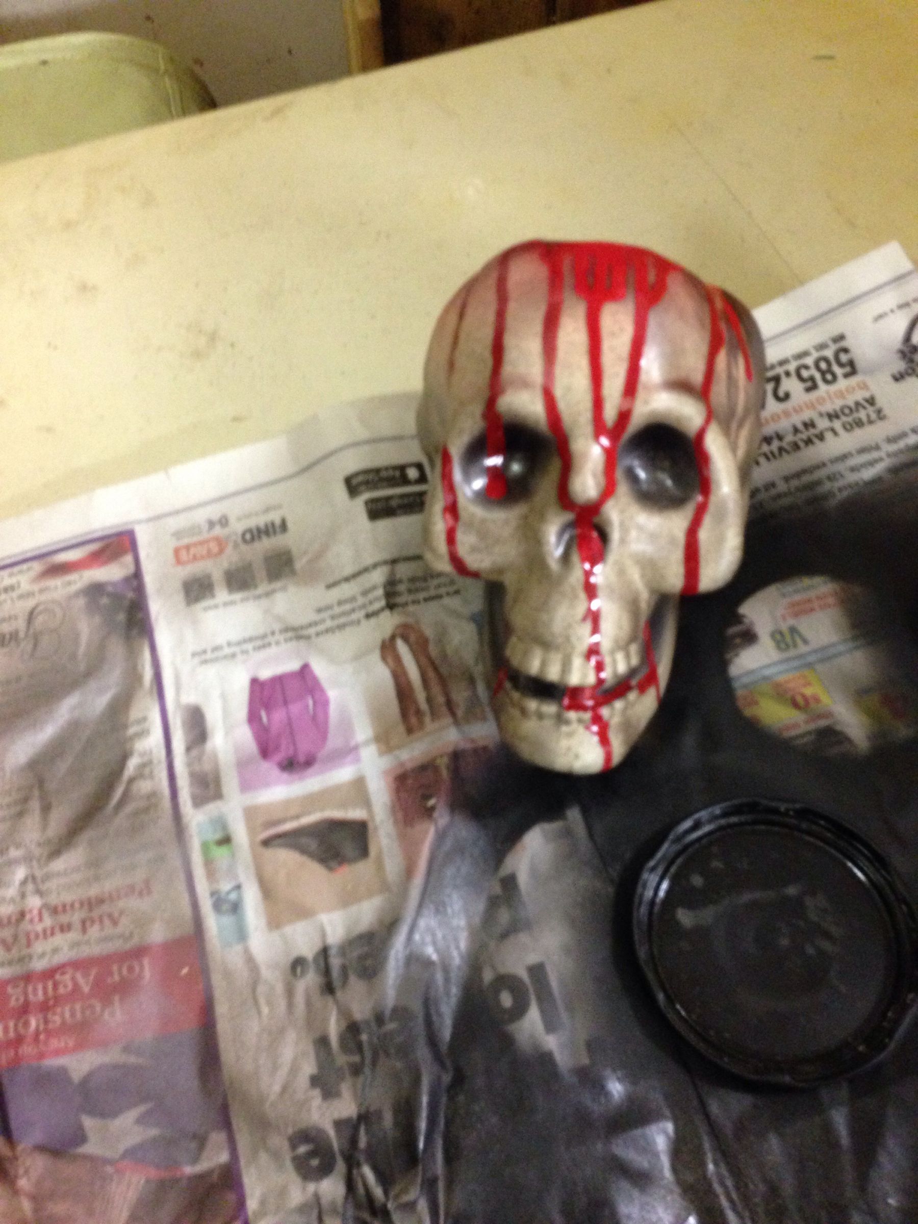

Step 4: Final - Decorating
I added red, black paint and some red spray paint. Dripped it down from the openings. I let it drip on everything to make it look more realistic. I also used red spray paint for. Accent. Lastly to make it look more aged i hit it with my mini torch and burned the wood in many spots.
