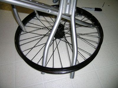

Step 3: Calculate the Leg Locations
I used three legs but in hindsight four would have been better. Three legs is a little tippy when the stool is high and a person is getting on or off of it.
Starting where the opening for the inner tube valve stem is, count the spokes on the rim you plan on being the seat. Mine was 36. I divided that by 3 and used that number to space each of the crutches out 12 spokes. Note that since each leg has two attachment points that the spacing will be from one leg "Y" to the corresponding "y" of the next leg. Mark the locations of the six attachment points with the marker.
Step 4: Drill Pilot Holes
I drilled a hole slightly smaller than the threads of the screws i used through the steel rim and then an even smaller bit for the pilot holes in the aluminum of the crutch leg. This is a safe place to experiment because it will be covered up unless you "upholster" the stool differently than i did. I also used the scrap pieces from the crutches to get a feel of how far i could put the screw into the aluminum before the screw stripped the hole. If you have problems with this then just bore the holes out and bolt through like the bottom rim will be.
Step 5: Assemble the Top
Put the screws in and admire the progress! Now measure 16" down from that rim and mark the inside of each of the legs. This is a comfortable distance (for me) to have my feet resting on the bottom rim. If you have a favorite stool measure the distance to find what works well for your leg length. By attaching the rim here the distance will stay where we like it no matter what height the stool is adjusted to.
Step 6: Ready the Bottom Wheel
After a bit of trial and error i found that it was important to notch out a section of at least the top flange of the bottom rim to allow the crutch to adjust in height while bolting the legs on securely. I drilled through either side of the adjustable leg portion and through the corresponding part of the rim. Then by sliding a few of the carriage bolts in i could mark the sections of the rim that needed to be trimmed back. I used the marker to also blacken the end of the bolt that was closest to the valve stem opening of the rim. That made sure i didn't have to fiddle with the rim and the legs trying to get bolts through misaligned holes. Cut the areas out for the center section of the leg. This could be done with a hacksaw and some frustration or you can use an angle grinder. Making a smaller cut on the bottom flange of the rim isn't a bad idea - if you tighten the rim and legs together too far the rim might press into the crutch leg and restrict the adjustment of the height.
