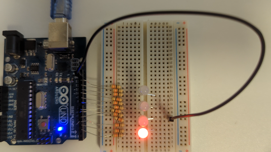

Step 1: POC - Electronics
My first step is always to test the idea. First, a few RGB LEDs were connected directly to Arduino to test their current direction. We figured out that we needed more LEDs than the available Arduino pins so we chose the SN74HC595N shift register to minimize pin usage. These registers can be controlled with 4 pins and output 8 digital signals each. One register is not a huge difference, but when 4 are concatenated, 32 digital output are controlled with only 4 pins and that's a big saving. We had to connect to each led 330Ohm resistor but we had only had a few so we came up with the idea of placing the resistors between the shifters and the power supply. That way we used only 4 resistors and the power to the leds was limited. While this idea has it drawbacks, we found out that it is perfectly good for our needs. After we overcame the resistors problem, we planned how to spread the leds, 26 leds for the game itself, 2 of them are the leds of the buttons. the other 6 leds are used for scoring - 3 for each player. We wrote test files for each main component - test32leds, test_74HC595 and so on. Only after all had positive results, we wrote a small sketch to make a possible game.

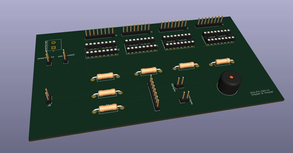

We could have used a breadboard for the final version, but we decided to order a PCB because—why not? Today, PCBs are inexpensive, and designing one didn't take us much time. We added an option for a buzzer and access to extra pins on the PCB in case we needed them. The PCB works well, but it was designed quickly due to time constraints, so it’s more practical than visually appealing. We designed the PCB using KiCad and ordered it from JLCPCB.
