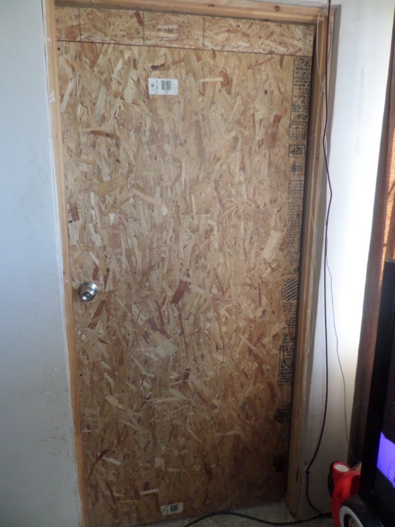

In this instructable ill be showing how to make a door thats also a closet to store almost anithing from blankets ,clothes to jewlery school suplies. The door im showing is diferentes from my desing becawse i coudent get the proper materiales so i made one of scrap wood i had leing arownd to give a idea of wath its supows to look so mine is smaller and ugly.

Turn frame arownd and glue and screw one of the wooden sheets to the frame.

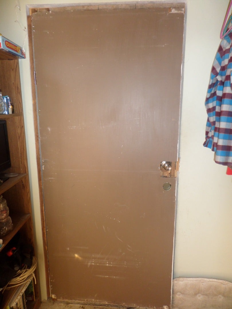

Turn frame around making the sheet be on the grownd and add the small 1 1/2 inch hings to the frame and screw the hings to the other sheet of wood to make a door for your closet door at the levels of 4 inches, 23 inches ,48 3/4inches and 75 3/4 inches from the top.
Step 6:
Drill 2 holes big enogh for the magnets to fit inside on the edge of the beam oposide to the one with the hings and glue together. Plase the magnétic catch latch at the side of the 2 by 2 by 4 piece of wood and glue or screw together. Glue the metal platea to the sheet of wood on the edges and in the middle so when the sheet closes the metal platea make contacto with the catch latch and the magnets .

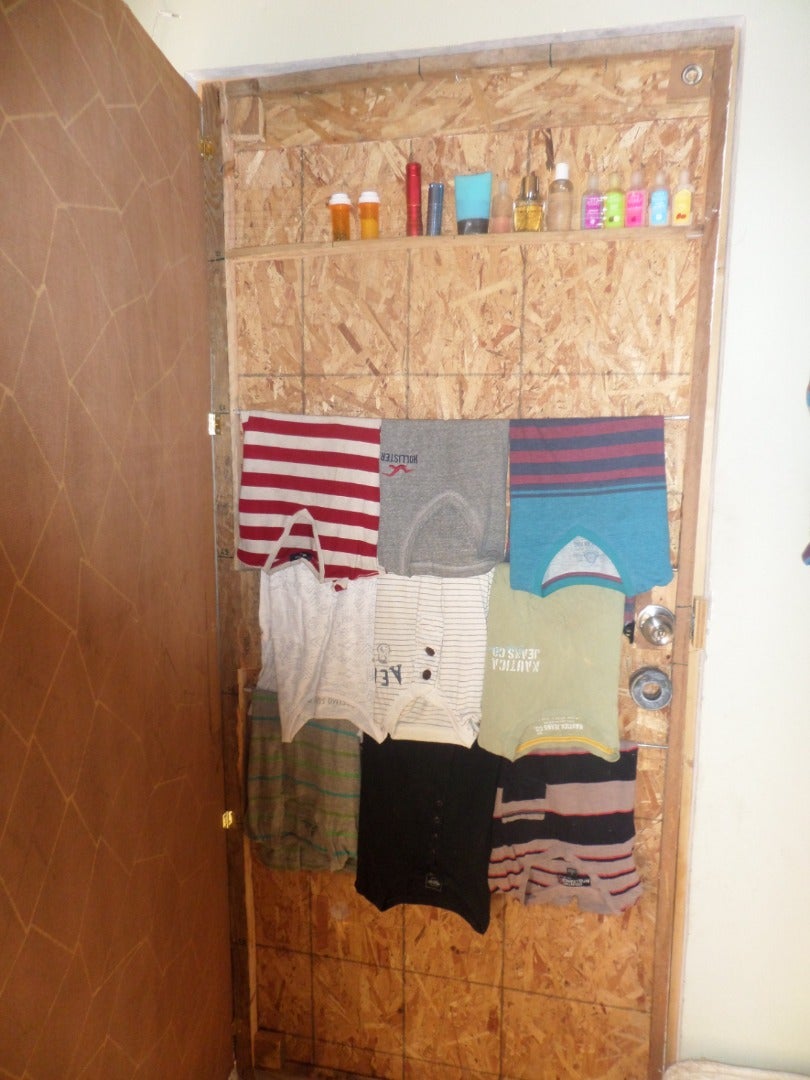

Install the stiks on the goles and your finish
You can install a little shelf to put other stuf insede or use it un the bathroom fot towels, shampoo, soap, thoot bruches, etc. Or use it to store craft suplies
