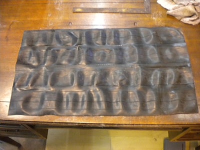

But there's a little problem with used tubes. Unlike brand new product being flat an nice, they have one side permanently stretched. It often results in crumbelled, wavy surface of sewn item. I "borrowed" last photo from sharpie.stories' instructable HOW TO SEW BIKE TUBES/VINYL. I'm not criticizing his work though. In fact I think he did a good job on that piece.
So, in this tutorial I want to share the results of my experiment on flattening/straightening used inner tubes for giving them more neat apperance in finnished crafting product and make them a bit more easy and pleasant to work with. I concidere this experiment being a success although I wasn't able to return tubes to their initial new-like condition.
