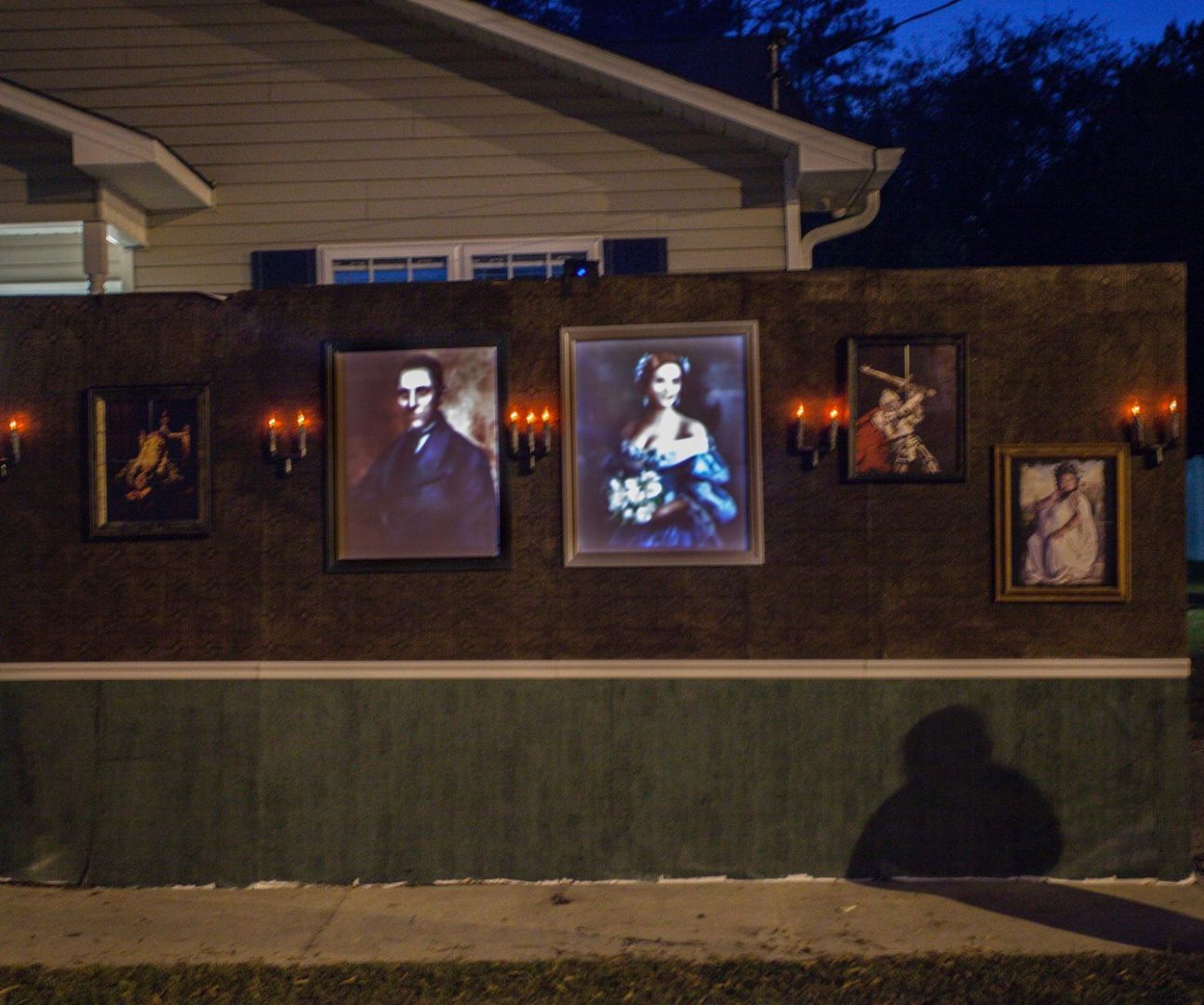

Last year, I made a Haunted Wall for our Harry Potter theme. I reused the panels this year in a slightly different configuration.
I found some old wallpaper or shelf liner, not really sure which, at a thrift store and the cheapest paneling and chair rail from Home Depot. Unfortunately the wallpaper didn't stretch far enough for the whole wall, but you can't really go out and buy another roll of 20 year old matching paper that easily.
I turned one of the former portrait holes into a recess for a vintage telephone (burned up of course) and the other portrait hole was boarded up and I used a Fire and Ice light to create the "portal" that we see in one of the episodes.
