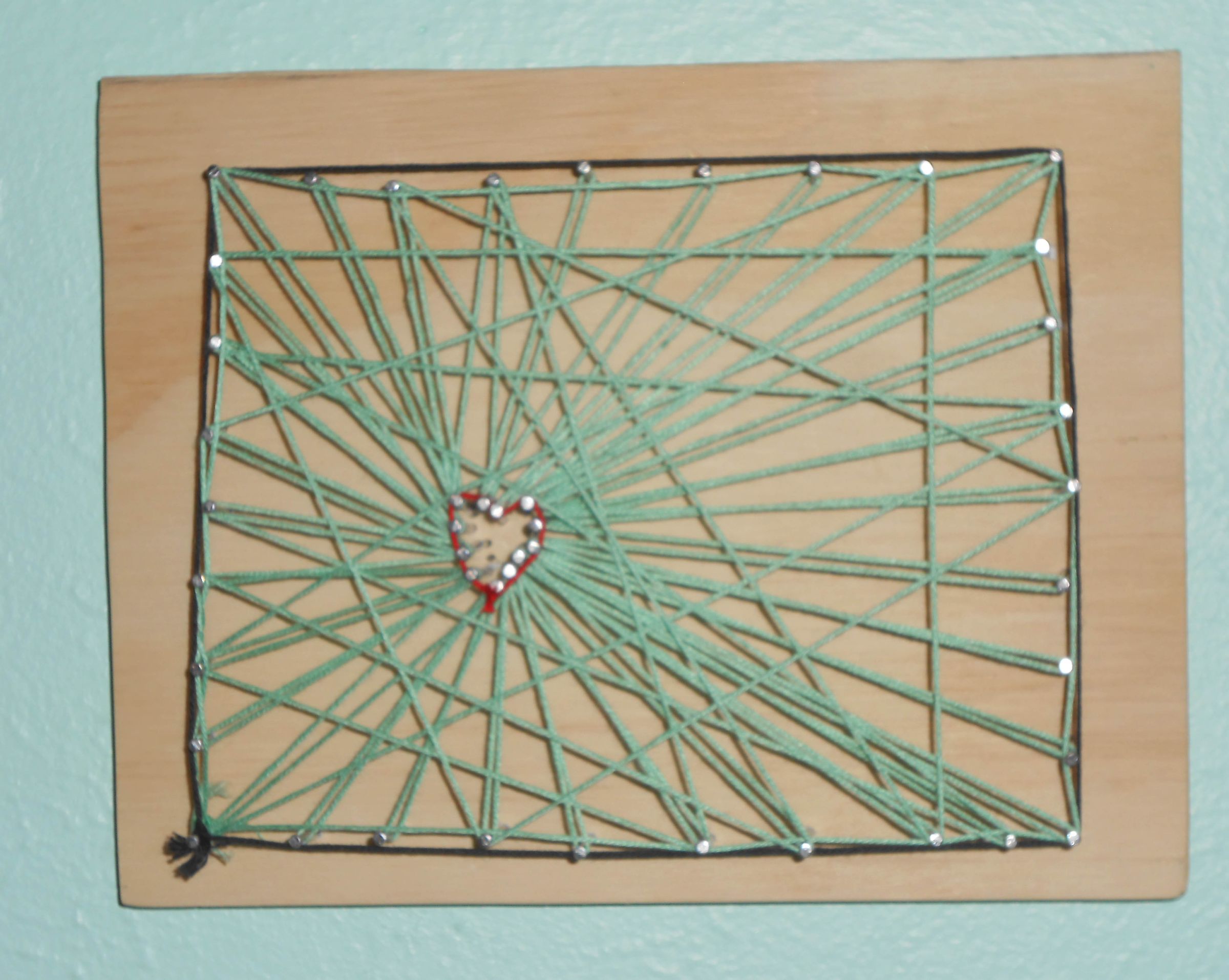

I first decided to make a radial pattern with the string, coming from the heart to all corners.
Then I decided to go nuts.
Which version do you prefer?

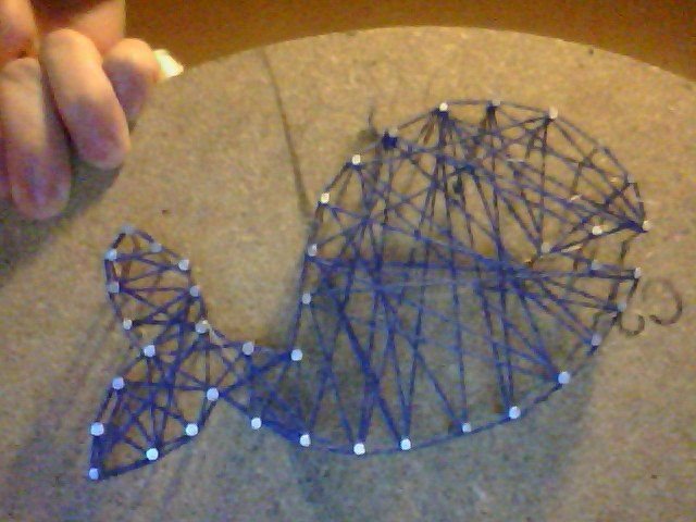

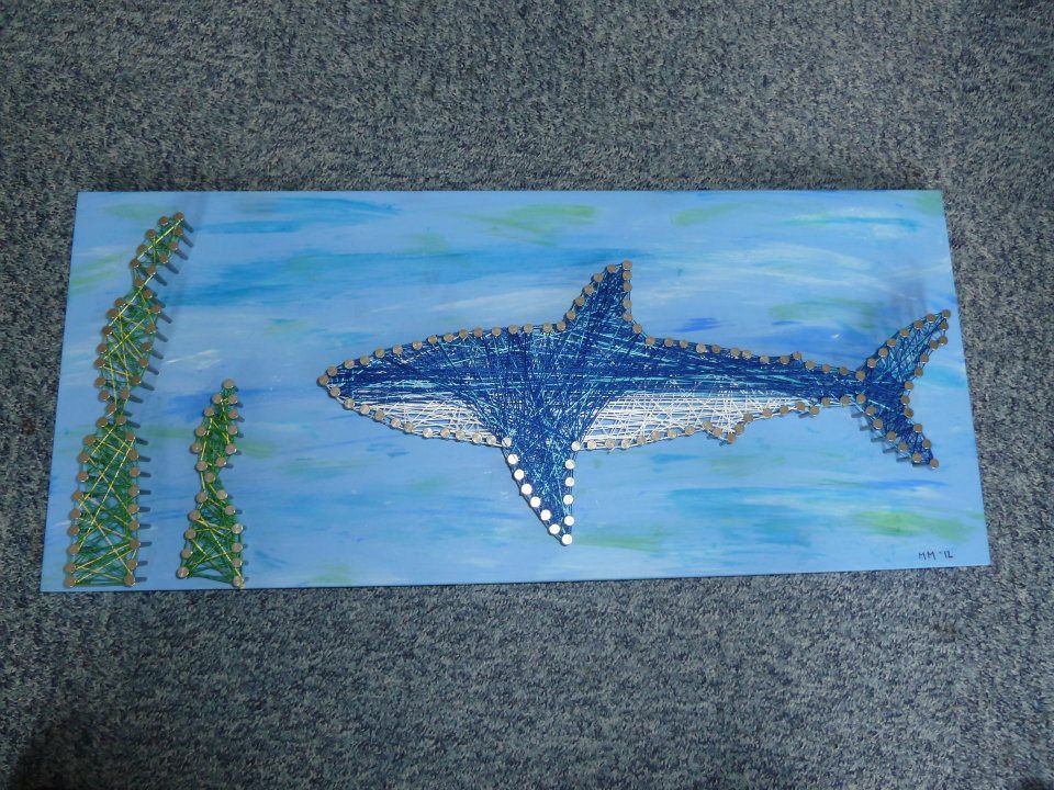

Very cool. Made this for a shark loving friend. Thanks for the great Instructable

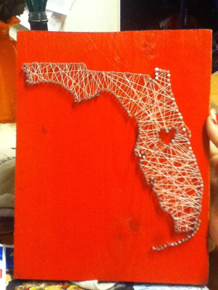

I did Florida

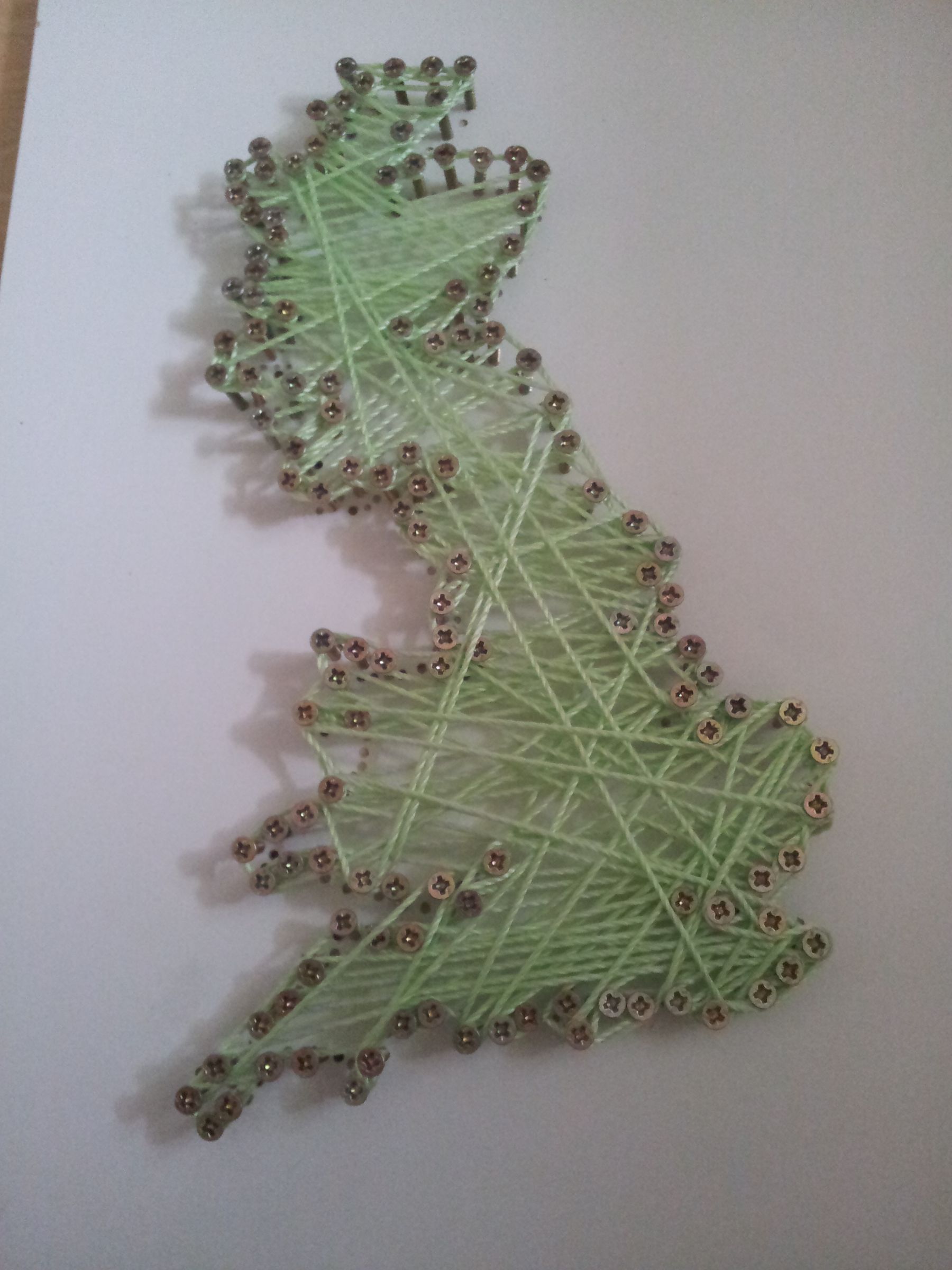

I didn't have a board big enough to do my country (Scotland) so I tried these two first.
Reply 11 years ago on Introduction
Adorable. I love them!

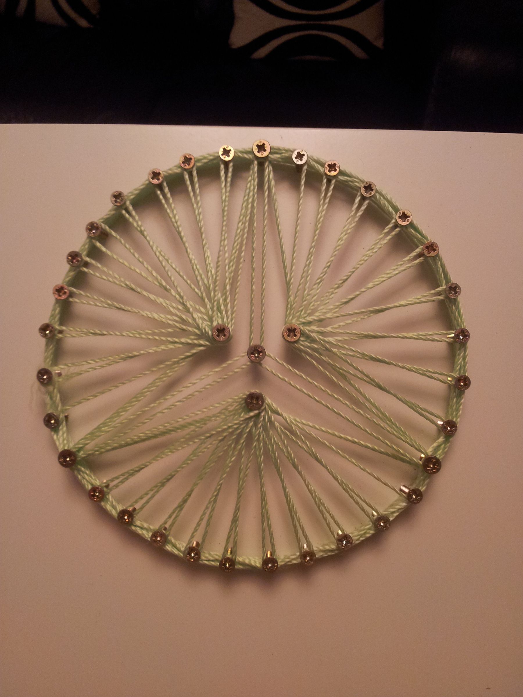

I tried something similar with what i had lying around. i know they are not perfect but the next few will be better (hopefully buy some nails)

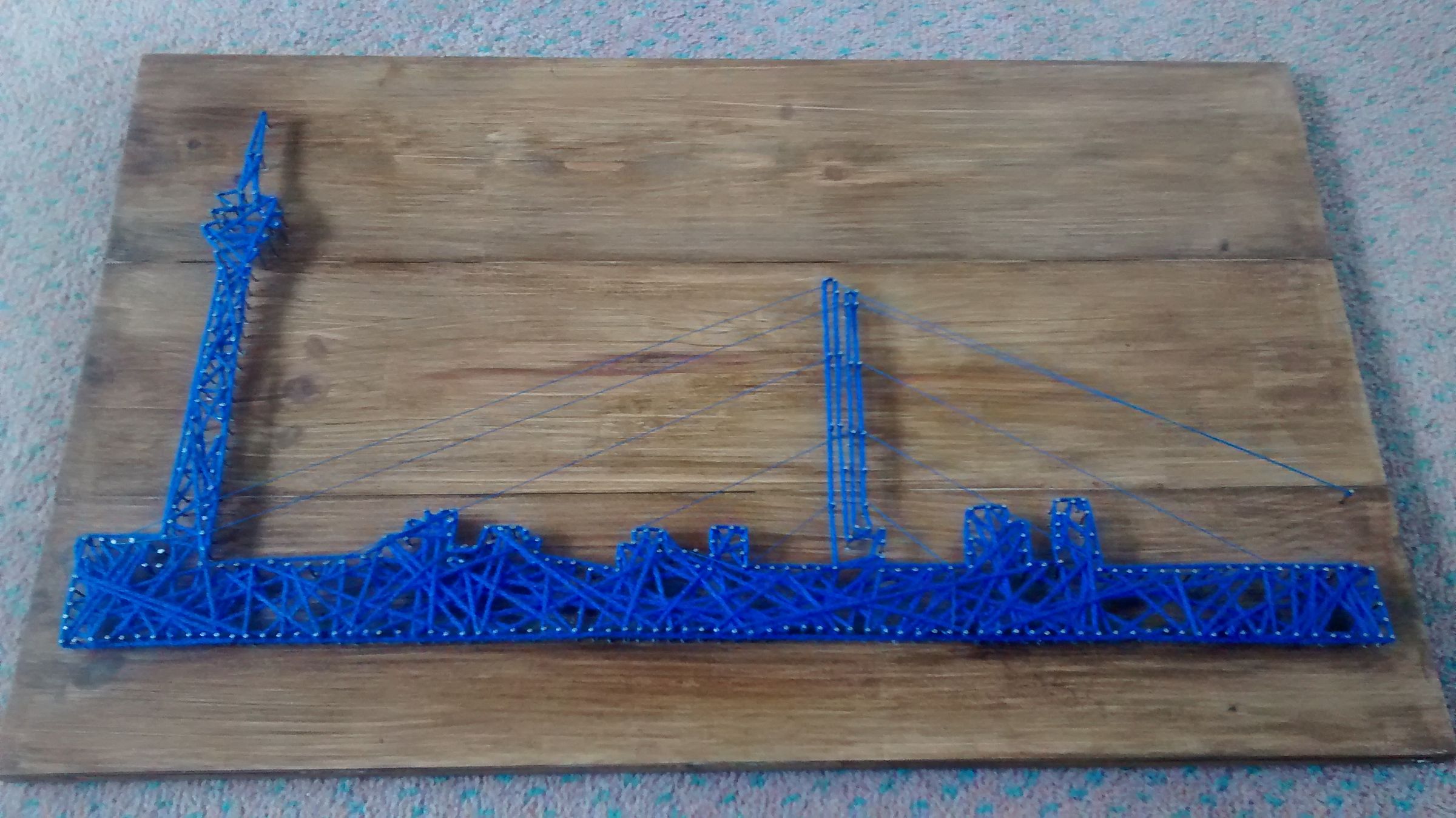

Awesome project, I was going to make a map of Düsseldorf, Germany, but it turned out way to complicated so i made the skyline over the Rhein instead! I used some floor panels that I had left over, stained and glued them together!

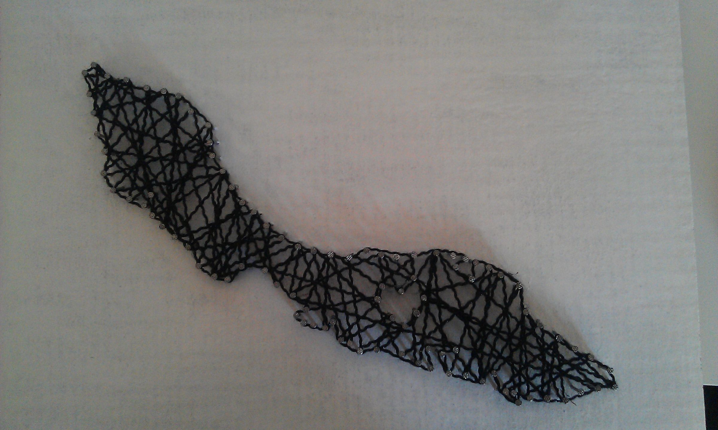

Thank you for this instructable! It was really fun to do. I made this as a Valentine's gift for my boyfriend, it's Curacao (where he's from).
