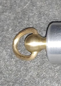

Step 5: Machining a Brass Lanyard
The lanyard is machined from 3/8 inch diameter brass and is about 3/4 of an inch long. Machine a ball on one end and cut 1/8-27 threads on the other end with a die. Two 1/8 inch holes are drilled into the ball on opposite sides the lanyard ring. The ring is made from 1/8 inch brass rod. This ring is a little tricky to bend properly so take your time. Use smooth jaw pliers to prevent marring. Carefully open the ring just enough to slip into the holes and press into place.
