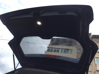

Add additional lighting in trunk. :)

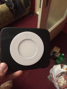

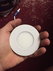

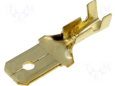

Buy LED light from local hardware 2 female and 2 male cable shoes and around 5 meter cable with 2 wires.

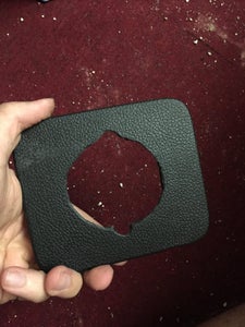

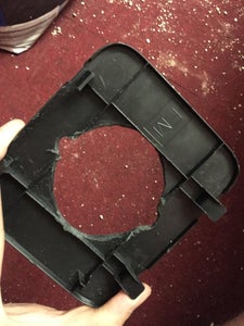

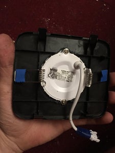

Remove the inspection hole for trunk's door locker and cut hole in it for LED light.

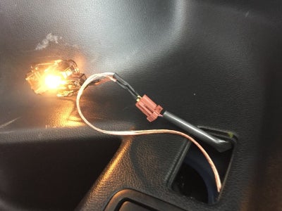

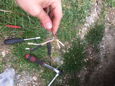

Disconnect the original light and use male shoes to connect the cable instead, then connect the original light with female cable shoes.

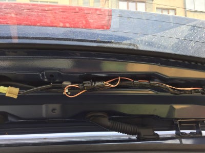

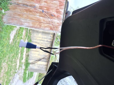

Disassembly the trunk's door plastics and run the cable through the door to inspection hole.

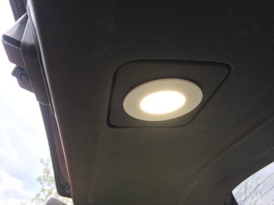

Connect and test the new lighting.
Step 4:
Assembly everything.
