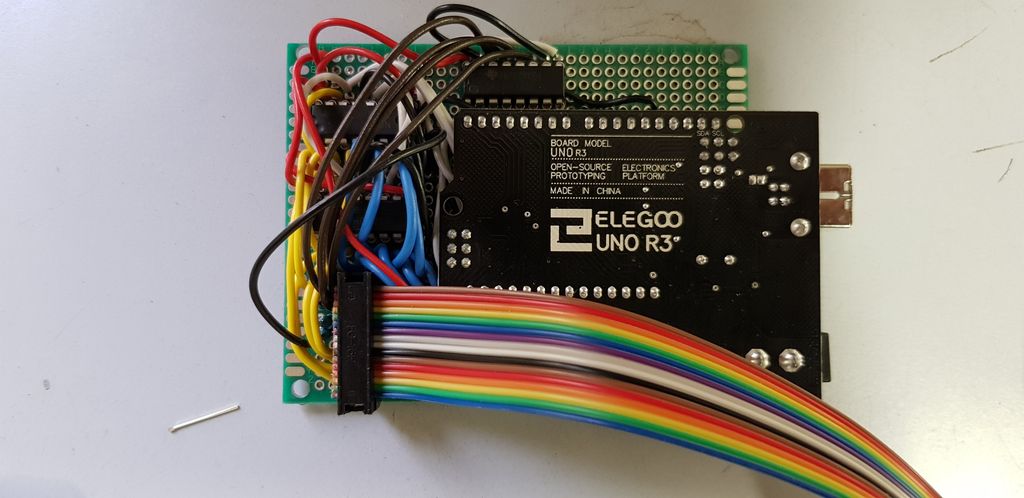

Step 2: Solder LEDs to Sparkfun PCB
Thread the leads of 16 LEDs (5mm or 3mm are fine, I used 5mm) through LED holes in the Sparkfun PCB. These boards are compatible with 4-lead RGB LEDs, so there are four available holes on each button pad. You can use the two center holes for single color LEDs (see figure 3). Be sure that the flat edge of the LED (the cathode) lines up with the flat marking on the PCB.
Solder the LED leads and cut away the excess wire.
Step 3: Solder Diodes to Sparkfun PCB
Solder 16 diodes to Sparkfun PCB. Be sure to line up black marking on diode (cathode) with the stripe on the PCB.
Step 4: Ribbon Cable
Cut about 1ft of 16 conductor ribbon cable. Separate and strip the ends of all 16 wires on one side and solder to Sparkfun PCB. The following list gives all the colored conductors in order with the name of the PCB hole they should be soldered to, if you do this correctly none of the wires should cross. Note that since I'm only using a single color LED, I'll wire up only the "blue" anode.
Connections:
(one side of ribbon cable)
Brown to SWT-GND1
Red to LED-GND1
Orange to SWT-GND2
Yellow to LED-GND2
Green to SWT-GND3
Blue to LED-GND3
Purple to SWT-GND4
Grey to LED-GND4
White to BLUE4
Black to SWITCH4
Brown to BLUE3
Red to SWITCH3
Orange to BLUE2
Yellow to SWITCH2
Green to BLUE1
Blue to SWITCH1
(other side of ribbon cable)
Step 5: Clamp Socket
Use a bench vice to clamp the16 pin socket on the ribbon cable. If you do not have a bench vice do not use pliers do this, you will clamp the socket on sideways and mess up the connections. You're better off using a hammer to tap the clamp shut, just make sure you are always applying pressure evenly across the socket.
Be sure the clamp the socket on the ribbon cable in the same orientation indicated in the images above.
Step 6: Multiplexing With Arduino and 74HC595
Two 74HC595s (wired in parallel) will be driving all the LEDs in the project as well as providing power to all of the buttons. The 74HC595 is an 8 bit serial in parallel out shift register. I've written a detailed tutorial about multiplexing with the 74HC595, and you can find more info about this chip on its datasheet. Please note that the 74HC595 drawn in the schematic is not a pin diagram, I have rearranged the order of the pins to make the circuit diagram more clear. The pin diagram for the chip is shown in fig 4.
The 74HC595 has the following pins (the technical name may be one of several things depending on which data sheet you are reading):
Position Common Name Technical Name
1 parallel output 2 QB or Q1
2 parallel output 3 QC or Q2
3 parallel output 4 QD or Q3
4 parallel output 5 QE or Q4
5 parallel output 6 QF or Q5
6 parallel output 7 QG or Q6
7 parallel output 8 QH or Q7
8 ground GND
9 serial data output QH' or Q7' or Q7S
10 master reset (active low) MR(with a line on top) or SRCLR(with a line on top)
11 clock pin SH_CP or SRCLK
12 latch pin ST_CP or RCLK
13 output enable (active low) OE(with a line on top)
14 data pin DS or SER
15 parallel output 1 QA or Q0
16 5 volts supply VCC
The connections between the 74HC595 and the sparkfun board are shown in the schematic and repeated below:
74HC595 / Sparkfun Breakout Board
Q0 to BLUE 4 and SWITCH 4
Q1 to BLUE 3 and SWITCH 3
Q2 to BLUE 2 and SWITCH 2
Q3 to BLUE 1 and SWITCH 1
Q4 to LED GND 4 (via current limiting resistor)
Q5 to LED GND 3 (via current limiting resistor)
Q6 to LED GND 2 (via current limiting resistor)
Q7 to LED GND 1 (via current limiting resistor)
The remaining pins have the following connections to the Arduino (also shown in schematic):
74HC595 / Arduino
Vcc to Arduino 5V
GND to Arduino GND
DS to Digital Pin 7
OE(line on top) to GND
ST_CP to Digital Pin 6
SH_CP to Digital Pin 5
MR(line on top) to Arduino 5V
Q7' - no connection

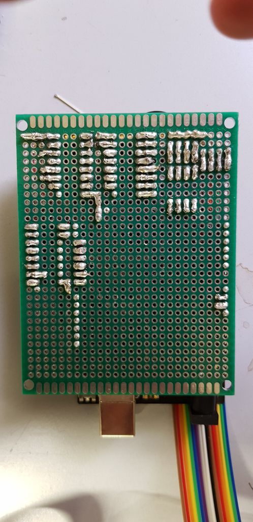

Step 7: Header Pins
Solder two rows of eight header pins to the protoboard. This is where the ribbon cable socket will attach to the board.
Step 8: Current Limiting Resistors
The 74HC595 will be driving the LEDs in the sparkfun board. However, this chip only outputs 0 or 5V and it can output as much as 70mA. This means we must use current limiting resistors to prevent damaging the LEDs.
From the specs of the LEDs I used:
max forward current: 30mA
forward voltage: 3.2V
Calculate the resistance needed to achieve these max ratings from V = IR:
resistance = (5V-3.2V) / (0.03A)
= 60 ohms
I used 68 ohm resistors so that I was not running at the absolute maximum, but also ensuring that I wouldn't lose too much brightness. (I made a mistake a grabbed the 100KOhm resistors when I made this project, I fixed it later, but the stripes of 100Ohm resistors should be blue, grey, black, gold, ignore the colors in the images).
These are the sample calculations for the specific LEDs I used, you'll need to do you own calculations based on the specs of your LEDs. If you are unsure of what to do, use 220ohm or higher resistors; using too much resistance will make the LEDs less bright, but they will not be damaged.
Solder four resistors to the protoboard as shown in the images. Connect the leads of the resistors to their adjacent header pins with solder (figure 2).
Step 9: 74HC595 Socket
Solder an 8-pin socket to the protoboard as shown in the images above.
Step 10: Connections to LEDs
As shown in figure 6, the output pins (Q0-Q7) are located on pins 1-7 and 15. This image was taken from the datasheet of the 74HC595. Connect the resistors to pins 4-7 with jumper wires as shown in figures 1 and 2. Connect pins 1-3 and 15 to the header pins according to the schematic (note the wiring in the image is incorrect, but the schematic is correct). The pins connections to the 74HC595 should be as follows:
Pin 15 - Blue 4
Pin 1 - Blue 3
Pin 2 - Blue 2
Pin 3 - Blue 1
Pin 4 - LED GND 4
Pin 5 - LED GND 3
Pin 6 - LED GND 2
Pin 7 - LED GND 1
Be sure to get these pin connections correct- do this part slowly and refer to the schematic often.
Make sure to electrically join all these connections with solder on the underside of the board (figs 2 and 4)

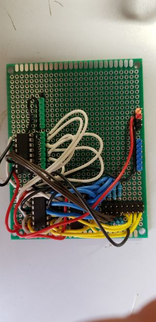

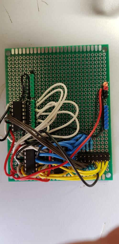

Step 11: Add Second 74HC595: Part 1
Each 74HC595 can only source 70mA at a time for all its pins. With the 100ohm current limiting resistors, if all 4 LEDs in a row are on at the same time (with multiplexing this is the max number of LEDs that can possibly be on at the same time), they will each draw about 18mA which puts the current requirements slightly above the 70mA maximum rating. I'll be drawing additional current from pins Q0-Q7 to multiplex the buttons (in later steps). An easy solution to this problem is to add another 74HC595 to the circuit, it will be wired parallel to the current 74HC595 (see schematic). This will give us additional 70mA to draw from on all 8 pins.
Add another 16 pin socket to the protoboard as shown in the images.
Step 12: Add Second 74HC595: Part 2
Wire pins 1-7 and 15 of the sockets to each other (see note on schematic). These pins correspond to all eight outputs of the 74HC595s.
Step 13: Add Second 74HC595: Part 3
Connect pin 8 (ground) and pin 16 (5V) of the sockets together (see image note on schematic).
Step 14: Add Second 74HC595: Part 4
Connect pins 11, 12, and 14 of the sockets to each other. These correspond to the clock, latch, and data pins of the 74HC595s.
Step 15: Add Second 74HC595: Part 4
Wire pin 10 to 5V (pin 16) and pin 13 to ground (pin 8). Pin 10 (MR) should be high and pin 13 (OE) should be low in order to send data to the output pins (Q0-Q7).
Step 16: Header Pins
Solder header pins to the perfboard so that an Arduino Uno can snap fit onto it. Be careful of the odd pin spacing between digital pins 7 and 8, I've designed this project so that connecting to pin 8-13 is not necessary, it's probably best to omit header pins for Arduino pins 0-13 so that things snap together easier (see image note).
Step 17: Connect 74HC595 to Arduino
Connect three 74HC595 data pins to Arduino digital pins 5, 6, and 7. Connect ground and 5V to Arduino corresponding power pins.
Pin connections:
74HC595 / Arduino
data pin (pin 14) to digital pin 7
latch pin (pin 12) to digital pin 6
clock pin (pin 11) to digital pin 5
Step 18: Test LEDs
Upload the code below onto the Arduino and test to see if LEDs are wired correctly. Insert two 74HC595s into the empty sockets, plug the button pcb into its socket, and connect the arduino to the protoboard (fig 1). You should see each LED light up one at a time, this loop will continue repeating forever (see video below). If this is not working, double check the connections in the previous steps and check all your connections for continuity. Do not continue onto the next steps until you get the LEDs working.
For more information on the 74HC595 and shiftOut, see fig 2, the datasheet, and the arduino reference page.

Step 20: 74HC165: Part 1
Solder a third 16 pin socket to the protoboard, this will be for the 74HC165. Connect 5V to pin 16 and ground to pin 8.
Step 21: 74HC165: Part 2 Pull Down Resistors
I used resistors in series with the buttons to pull D0-D3 of the 165 chip down to ground while the buttons are not pressed - this is called a "pull down resistor". Solder four 10kOhm resistors to the pins adjacent to the header pins (see fig 1). Connect four wires from the 74HC165 inputs D0-3 (pins 11-14) to the space between the male header pins and the 10k resistors as indicated in fig 3 and in the schematic (also see yellow wires in fig 2). Drag solder between the header pins, the wires to the 165 chip, and the resistors to connect them (see fig 3). Connect the other side of all four resistors to each other and to Arduino ground (again see fig 3 and the schematic).
We'll be powering the buttons with the same supply that is powering the LEDs - the 595 chips. Drag solder between the header pins that connect to the LED-BLUE (1-4) on the sparkfun board to the header pins that connect to SWITCH (1-4) on the sparkfun board (see note on fig 3 and 5).
Step 22: 74HC165: Part 3
Connect the data pins of the 74HC165 to the Arduino (brown wires)
Pin connections (also shown in schematic):
74HC165 / Arduino
PL(line on top) (pin 1) to digital pin D4
CP (pin 2) to digital pin D3
Q7 (pin 9) to digital pin D2
Step 23: 74HC165: Part 4
Connect ground to pins 15 (CE with line on top) and 10 (DS) of the 74HC165.
Step 24: Test Buttons
Upload the following code onto the Arduino. If everything is wired correctly each button will light up while pressed. If you're noticing that some buttons are not as responsive try cleaning the conductive rings and the traces on the pcb with water and drying thoroughly, this solved some response problems for me.

hi
i doing this project and acutally test with sperate led matrix and button matrix
connected on test board
the step 27 is ok 1 led 1 button 1 note
but after when i load the full program in arduino nothing happens
It's possible to have one program for the stepsequencer or just a lead to know that run?
thanks in advance
I also made it with Sparkfun Pcb i have same problem the step 27 is ok
when i load the final program nothing happens (i set the pin of the 595n and 165n in program)
0
mcgreg1
mcgreg1
Reply 12 months ago
Hi Mathieu,
I had the same issue.
it took me some time, but i figured out that the shift(byte i) function in the full program (SugarCube.cpp) have some hard coded pin operations (e.g. PORTD|=B00100000). If your wiring is different than Amandas you will run into that issue.
You need to change it back where the pin values are taken from variables.
Example:
PORTD|=B00100000
needs to be changed to :
digitalWrite(ledClockPin,HIGH);
and so on.
Since i have issues to upload it to a atmega32u board, I'm rewriting the code, so I run over this.
/Gregor

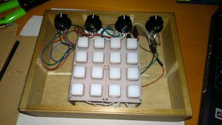

3 years ago
Thx for this amazing instructable!
Still busy trying things out and modifying it...
My progress so far:
0
amandaghassaei
amandaghassaei
Reply 3 years ago
nice, glad to see this worked! what are you going to do with it next?
0
BGprojectz
BGprojectz
Reply 3 years ago
Thx! First making a enclosure.
I did use RGB LEDs. Would be nice if i can modify the circuit and program to let it change colors.
And if above works, maybe showing little animations on it.
