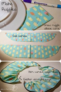

Step 2: Make Ruffles
Round off the ends of each ruffle piece. Remember to make them mirror images of each other. (I simply used the edge of a plate as a template.)
Finish the rounded edge of the ruffle using a narrow hem or rolled edge.
Gather the unfinished long edge of the strip.

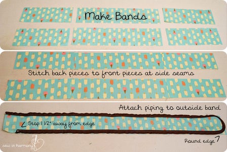

Step 4: Make Bands
Sew back pieces to front pieces along short edges for both outside and facing.
Press seams open.
Optional Step: Attach piping to the outside band. Stop piping 1½ inch from the left bottom edge.

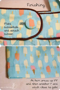

Step 9: Finishing
Mark your button placement and make your buttonhole(s). Attach your buttons.
Along the hem press under 1/4 inch and then fold up another 1 inch and press.
Stitch close to the fold to secure the hem.
