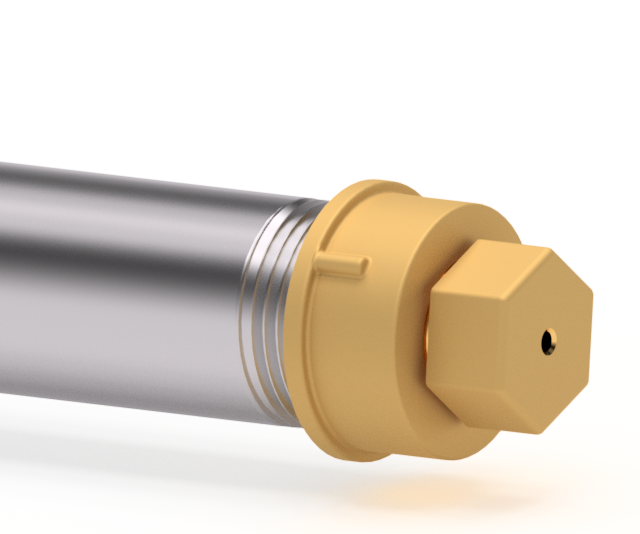

Step 5: Step 5 : 3D Print the Tube Holders
Print the attached 3D files, preferably in ABS
Step 6: STEP 6 : Assemble the Thermical Sun Collector
The sun collector made is made of tempered glass and can provide temperatures above 250°C
To fixe the tube tighten the screws of the 3D printed front holder
The overall size is 660 mm (overall) X 127mm outside diameter. The approximate interior dimensions are: 584 mm X 101mm inner diameter.
