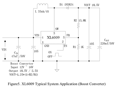

Step 4: Hack the Booster Module
The default Xl6009 booster module can output a max of ~35V, but the LEDs require higher voltage. I could buy a booster with a higher rating, but I found a simple hardware trick to hack the module.
According to the datasheet, the feedback is connected to two resistors, R1 and R2. The ratio of these two is used to determine the output voltage.
Vout = 1.25*(1+R2/R1)
Thus, I replaced the resistor R2 with a 330ohm resistor. By varying the resistor, I can get a practical voltage of up to 75V!
However, this method also introduces noise at the output, so it is unsuitable for sensitive circuits. For my LEDs, this is more than enough.

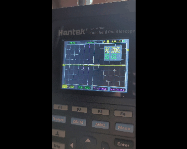

Step 5: Build the Timer Circuit
When I press the switch, the ne555 turns on and triggers high. After a designated time, the output of the IC goes LOW and turns off the power flow.
This timing is done by charging and discharging a capacitor connected to pin 6 of the IC.
Note that ne555 in monostable configuration requires an initial trigger for activation; this is done by a small circuit consisting of capacitors C4 and R3. This provides the initial pulse required, as you can see from the gif.

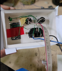

Step 7: Build the Control Box
Modeled the design using Sketchup. Took precise measurements of the components to make them compact.
I used 3mm PVC board to make the control box. It is easy to cut using an anti-cutter.
I made a 2D diagram in Illustrator and printed it on A4 paper to make the sticker for the box.
