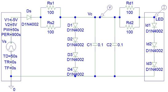

Step 1: Design the Circuit
The four diodes could have been replaced with a Zener diode. However, those are low cost high power and high current diodes that I used. The only look expensive (refer to make the circuit step). The maximum current is 1.5 Amps.
I drawn the circuit in free student edition software to save money. Thus I had to model the bright LED with three typical diodes.
Calculate maximum LED current:
Iled = (VcMax - Vled) / (Rd1||Rd2)
= (4*VdMax - Vled) / (Rd1||Rd2)
= (4 * 0.7 V - 2 V) / (100 ohms * 100 ohms / (100 ohms + 100 ohms))
= (2.8 V - 2 V) / (10000 ohms / 200 ohms)
= 0.8 V / 50 ohms
= 16 mA

Calculate charging time constant:
The charge time constant for capacitor voltage under 2 V is:
Time Constant = Rs1||Rs2 * (C1 + C2)
= 100 ohms * 100 ohms / (100ohms+ 100 ohms) * (0.1 F + 0.1 F)
= 50 ohms * 0.2 F
= 10 seconds

Step 2: Simulations
Simulations showed that the capacitor voltage discharges very quickly to 2 V but takes longer to fully discharge.
The maximum current is 14 mA, not 16 mA, probably because the maximum LED model voltage is slightly higher than predicted.

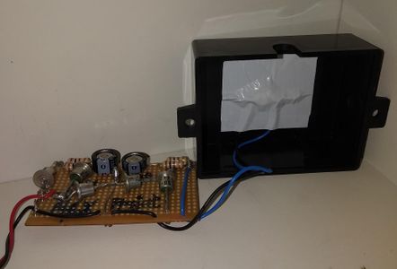

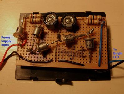

Step 3: Make the Circuit
You will need high power resistors for Rs1 and Rs2 but low power resistors for Rd1 and Rd2. However, you can see that I used high power resistors (1 Watt) for both pairs because I had them in stock and it is easier to read the resistance value in the photo if you use bigger resistors.
Step 4: Encasement
I used a drill to make the hole for the bright LED.
My encasement can close without any screws. However, I have to apply force to open and close my box.

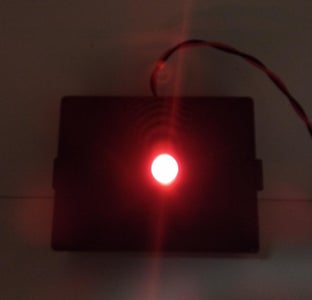

Step 5: Testing
Testing showed that the LED is ON for many seconds after the power supply is disconnected.
