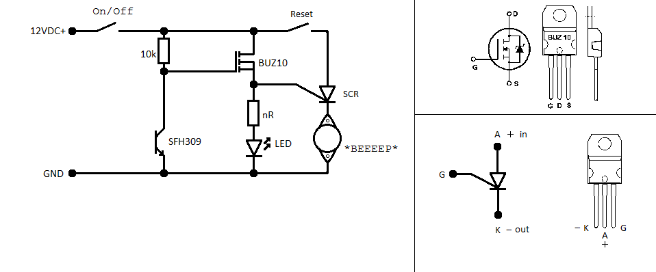

If you are unexperienced with electronics, just copy the schematic 1:1
and put it on a board.
Hook up the laser to a separated battery, make it hit the phototransistor,
then switch on the board. Break the beam and the LED should light up.
EASY was not a lie, thats it. You can now switch a multistage coilgun with it,
protect your room or door.
