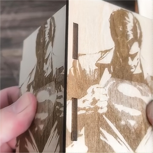

Step 1: Download the File
Download this svg file for your lightburn or the laser software you prefer.
Step 2: Upload the File
You will need to cut and engrave with this file. I use light-burn as my laser working software. The laser cutter I used is 20w NEJE Max 4. If your machine is similar to mine, you can refer to my settings. If not, you may need to test it first.
For Engraving, I use 15000mm/min,60%power, 254dpi and garyscale engraving mode.
For cutting, I use 400mm/min,90%power
Step 3: Laser Engraving and Cutting
Your machine should be large enough for laser engrave and cut a 35*25cm plywood sheet. Otherwise, you may need to adjust your file. I used NEJE MAX 4(750*460mm)which is large enough for me to make it.
Step 4: Assembly
You can put the phone holder on the left and the pen holder on the right, or you can put the phone holder on the right and the pen holder on the left. This installation direction depends on your preference. After the production is completed, assemble it according to the order of the picture. The installation method is similar to most pen holders and mobile phone holders. (Because the thickness of the wood can vary slightly, you may need glue to secure it.)
Step 5: Enjoy Your Work!
It can be used as a desktop pen holder or a mobile phone holder. You can replace the engraved pictures to make this double holder you like.
