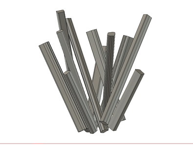

Since each rod is as distinctive as the superheroes in the Justice League, I can't give you a pre-designed STL file to 3D-print. Plus, how you arrange your crystals will vary depending on how many you have and what you find aesthetically pleasing. This means you will need to design and print your own base. The cool thing is that this means your light will truly be one-of-a-kind.
It's beyond the scope of this Instructable to teach you Fusion 360, and you might have a different CAD program you already know how to use. There are many other Instructables and YouTube videos out there that can get you started with CAD. What I can do to help is outline the steps I took in Fusion, and at each stage include "search tips" and links that you can use to find helpful tutorials related to that activity. This is not complicated CAD work. If CAD is your Kryptonite, fear not—helpful tutorials are your ally, and even a basic design can become a masterpiece.
  1. Import the rod outlines into Fusion 360 as a Canvas (Fusion docs, search: Fusion 360 import image canvas)
  2. Create a sketch on the same plane as the Canvas image (Fusion docs, search: Fusion 360 create sketch)
  3. Using the sketch tools, create a closed outline around the tracing of each rod (search: Fusion 360 trace around canvas)
  4. Finish the sketch and return to the Design editor in Fusion. Now, extrude each outline individually, starting with your first crystal in order through the last. When you extrude a sketch to create an object, Fusion will automatically name it Body 1, Body 2, etc. These numbers should match the number you wrote on the bottom of the particular crystal. The length of the extrusion should be set to the length of the rod you measured earlier. (Fusion docs, search: Fusion 360 extrude sketch)
You now have a set of bodies in Fusion 360 that match your selenite crystals. After we design our base, we are going to use these as cutting tools to make holes in it to hold the selenite rods. We need to make sure the holes are slightly bigger than the rods, so that they will slide in easily. To do this, we're going to want to scale each body in our model to make it just a little bigger.
Repeat this process for each rod: Select the a rod and scale it up by 10% (Fusion docs, search: Fusion 360 scale body)

Now it's time to arrange the rods. Maybe you want them all arranged vertically, or maybe you want them to appear like a natural crystal (as I have done). It's completely up to you. Use the Fusion 360 Move command (search: Fusion 360 move body) to arrange all of the bodies. Play close attention to make sure the bodies never intersect with one another. If they do, it will be impossible to assemble the crystals in the real world.
Once you are happy with your crystal arrangement, it's time to make the base.

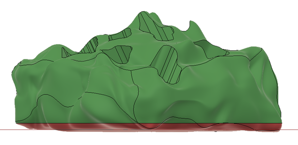

I'm going to give you two options; one is very simple and one is a little more complex:
  • Option 1: Create a simple, rectangular base. To do this, you will need to create a new sketch in Fusion 360, draw a simple rectangle, and extrude it into a block (see sample image). Since you've already drawn the outlines of the crystals and extruded them, you already have the skills to complete this task.
  • Option 2: If you want a more natural, rock-like form, you can use Fusion 360's "Create Form" capability to sculpt something more organic (Fusion docs, search: Fusion 360 sculpt object)

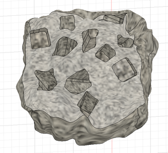

I've included sample renderings of a rectangular base and a sculpted base that I made. Notice in the sample image (with the see-through blue base) that I arranged my crystals so that they don't pass all the way through the base.
Once you have a base designed around the rods, we need to "cut" the holes in it. We'll use Fusion 360's "Split Body" command (Fusion docs, search Fusion 360 split body). Select the base as the "Body to Split" and select all of your crystals as the Splitting Tools (do not check the Extend Splitting Tools box). When the command is complete you can hide all the pieces that have been cut out. You can hide the crystals now too - we don't need them anymore. You will be left with just 1 body visible in Fusion - the base- with the openings for the crystals.

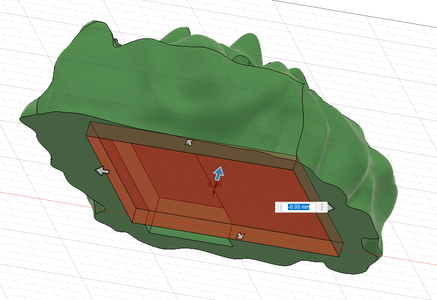

Now we have a solid base with openings for the crystals. We need to slice off a little piece of the bottom to make a cover-plate (to enclose the electronics).
Create an offset plane in Fusion (Fusion docs) about 5-10mm from the bottom of your base, and then use it to split the base in 2 pieces. For illustrative purposes, I've included a sample image of my base with the top half of the cut in green, and the bottom half of the cut in red. Once you've made this cut, hide the bottom object in Fusion (Fusion docs)
Now we need to cut some holes in the top half to mount the NeoPixels in the each opening.
Using Fusion 360's Hole command (Fusion docs) cut a counterbore hole (see image for dimensions) in the center of bottom of each hole. The hole is designed to fit the size of the Neopixel. Make sure the depth of the hole is long enough to pass through the entire body.

  1. Create a sketch on the flat bottom surface of your model (the top half of the base)
  2. Draw some rectangles on the sketch to mark the area(s) you will remove from the top
  3. Extrude them into the base to cut out some openings (see sample image)
Make sure that the area you cut out covers all of the holes you made so that you'll be able to keep all the wiring enclosed.

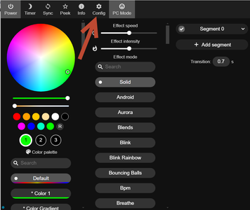

On the WLED homepage for your device, there is a Config button at the top of the screen. Click it.
We're going to change a couple of the settings. On the next screen that appears, click the "LED Preferences" button.

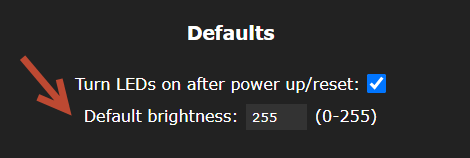

Then scroll down to the Defaults section and set the default brightness to 255. We want these crystals to really glow!
Save your settings by clicking the Save button at either the top or bottom of this page. You can then disconnect your ESP board and set it aside for the next step.

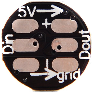

Set aside a separate Neopixel for each selenite crystal. These LEDs are often sold in sheets, so you will need to gently break each one away from its neighbors.
Take a look at the back of each Neopixel. There are 6 solder pads. If you orient yours the same as the picture I have attached to this step, then the top 2 pads are for 5 volts, the bottom 2 pads are for Ground, and the middle 2 pads are for Data. Specifically, the left-middle pad is for "Data In" and the right-middle pad is for "Data Out".
The Data-In and Data-Out pads are how we will chain the Neopixels together, and it's with this data line that the ESP will be able to communicate with each LED individually.
Before we start soldering wire, let's agree on a few wire-color standards that will make life easier down the road:
  • Red will be used for 5V. And we're only going to solder Red to the top-right solder pad.
  • Black will be used for Gnd (Ground) and we're only going to solder Black to the bottom-right solder pad.
  • Green will be used for Data-In, and we'll only solder it to the middle-left pad
  • Yellow will be used for Data-Out and we'll only solder it to the middle-right pad.

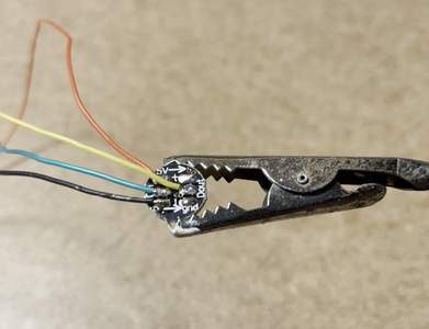

Go ahead and solder a short section of wire to your red, black, green, and yellow Neopixels. The length of the wire needed depends a lot on how big you have made your base. I used about 6" and I had a lot of extra wire left over. I could have trimmed it, but honestly it's so thin and flexible I just stuffed it all into the bottom (see photos).
My light uses 11 crystals, so I made 11 of these little guys.
