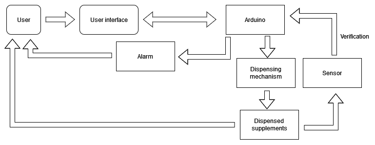

After the functional analysis has been performed, a brainstorming on the high level-design started. Here, the operating principles have been defined and the interaction among the different components and the user have been laid out, as shown in the above block diagram.
In the figure, the arrows are representative of a one-way relationship or influence between the 'sending' block and the 'receiving' block. Instead, the double arrows are representative of a reciprocal influence between the blocks.
As shown, the user can interact with the user interface, which will command the Arduino. The Arduino can then influence the alarm or the dispensing mechanism. In the same way, the alarm interacts back with the user with an audible tone. Moreover, if the dispensing mechanism is activated, the appropriate pills can be extracted for the user and this operation is verified by employing some sort of sensor.
This layout outlines the high-level design for the Supplement Bot and constitutes the basis of all the design steps and choices made in the successive sections.

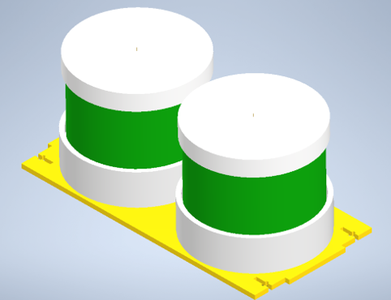

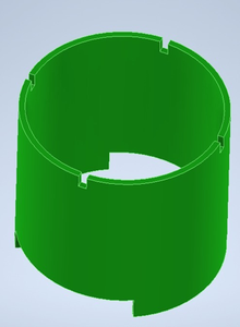

Container
The main function of the container is to stock all the pills.
Concerning the requirements, the container must be fillable by hand and filled just periodically. The container needs to be removable to assure some flexibility. It is also important to check somehow whether the container is empty or not. Since the weight of each pill can vary, the choice for the stock check is to avoid using a weight/pressure sensor, but employing a simple visual check performed by the user.
The first conceptual design for the container is a simple open tube, whose dimensions depend on the pill volume and the pill consumption. In order to allow the visual check for the pill stock, the container is made of transparent material. For testing, a standard 00 pill type is used, a capsule shaped pill with a radius of 8 mm and a length of 24 mm. The volume V of the container can be calculated as V = 3*30*Vpill + 15%. Here, a pill consumption of three times a day and a filling of once per month is considered. A tolerance of 15% is also taken into account. The obtained dimensions for the container are then 100 mm as outer diameter, 94 mm for the inner diameter, and a height of 80 mm. The prototype for the container has been 3D printed and made in PLA.
After experimental testing, some improvements to the part have been applied. In particular, on the top edge, some holes are added in order to shape fit the barrier part (described below) and the cross barrier to provide stability to the barrier wall. Moreover, in order to prevent the part from rotation (which happened during testing, producing unreliable extracion), the bottom edge is modified in order to be fixed via shape fit into the extraction mechanism.

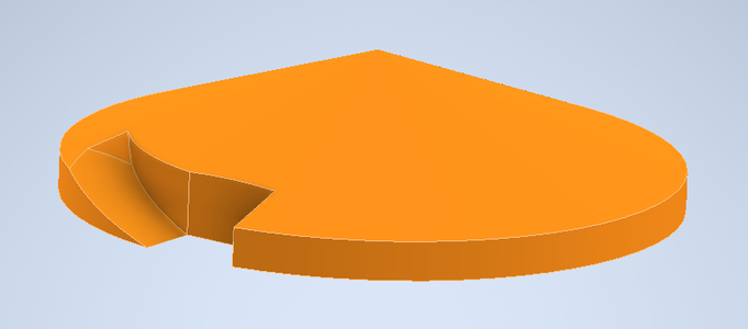

Top rotating disk
The first part of the extraction mechanism is the top disk. In order to ensure a single pill extraction, the disk has a hole whose dimensions correspond to the extracted pill’s dimensions. To make the disk rotate, it needed to be connected to the motor by means of a shaft.
The idea for the initial design is a flat disk with an embedded shaft. As a first conceptual design, the disk had a diameter of 92 mm and a thickness of 10 mm. The dimensions of the hole are 11mm x 25 mm, which is slightly bigger than the dimensions of a pill to allow a slight backlash with respect to the pill size. The hole is at a 25 mm radial distance from the center. The prototype of the top rotating disk is 3D printed and made of PLA.
After some tests, it is clear that the first design needed to be improved to ensure a single pill extraction. First, a chamfer has been added to the hole to improve the pill positioning in the extraction. Afterwards, the disk’s shape is modified to a conical shape and the position of the hole is pushed far in radial direction, in order to better drive the pills towards the hole thanks to gravity. Finally, the connection of the disk to the motor has been modified from an embedded shaft to a separate connector part which fits into the motor and can be fixed to the rotating disk using brass inserts and screws.

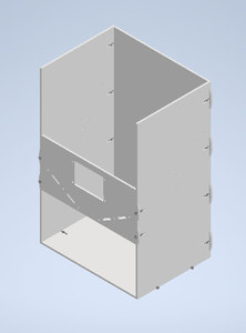

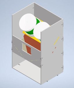

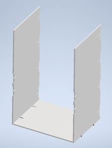

To fix the tilted plate, the extraction mechanism, and the funnel, a support structure is needed. Inside this structure, there must be a place for all the electronics. This support has to be solid enough. It also needs to be large enough to contain everything. The containers must be visible as well, since, as mentioned before, the stock of the pills is checked visually. To make the extraction mechanism work, a touchscreen is used, and therefore, needs to be fixed and remain accessible.
The design of this structure consists of a bottom plate, two side plates, a back plate, and a front plate. All the plates are fixed together with bolts and nuts. The plates are laser cut and made of MDF wood. The dimensions of all the plates can again be found in the CAD files . To reduce the chance of breaking, the amount of wood around the holes is increased. The holes needed to fix the touchscreen, the funnel, and the tilted plate are added as well.

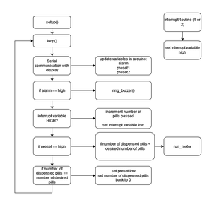

Code flow diagram

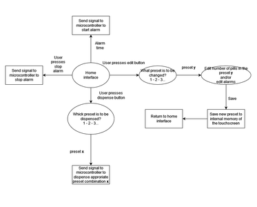

The code flows for both the touchscreen display and for the Arduino code are seen in the figures above.

  pinMode(interrupt_pin2, INPUT);
  attachInterrupt(digitalPinToInterrupt(interrupt_pin1), interrupt_routine1, RISING);
  attachInterrupt(digitalPinToInterrupt(interrupt_pin2), interrupt_routine2, RISING);
  digitalWrite(dirPin1, LOW);
  digitalWrite(dirPin2, LOW);
  numberOfPills1 = 0;
  numberOfPills2 = 0;
   trigger0: dispense preset1
   trigger1: ring alarm
   trigger2: stop alarm
   trigger3: dispense preset2
   trigger4
void loop() {
  myObject.NextionListen();
  if (alarm == 1) {
    ring_buzzer();
  if (STATE1 == HIGH) {
    numberOfPills1 = numberOfPills1 + 1;
    STATE1 = LOW;
  if (STATE2 == HIGH) {
    numberOfPills2 = numberOfPills2 + 1;
    STATE2 = LOW;
  if (preset1 == 1) {
    if (numberOfPills1 < desiredPill1 ) {
      run_motor1();
      delay(500);
    if (numberOfPills2 < desiredPill2) {
      run_motor2();
      delay(500);
  if (numberOfPills1 == desiredPill1 && numberOfPills2 == desiredPill2) {
    preset1 = 0;
    numberOfPills1 = 0;
    numberOfPills2 = 0;
  if (preset2 == 1) {
      run_motor1();
      delay(500);
      run_motor2();
      delay(500);
    preset2 = 0;
    numberOfPills1 = 0;
    numberOfPills2 = 0;
void trigger0() {
  preset1 = 1;
  desiredPill1 = myObject.readNumber("page4.n0.val");
  desiredPill2 = myObject.readNumber("page4.n1.val");
  numberOfPills1 = 0;
  numberOfPills2 = 0;
void trigger1() {
  alarm = 1;
void trigger2() {
  alarm = 0;
void trigger3() {
  desiredPill1 = myObject.readNumber("page5.n0.val");
  desiredPill2 = myObject.readNumber("page5.n1.val");
  preset2 = 1;
  numberOfPills1 = 0;
  numberOfPills2 = 0;
void interrupt_routine1() {
  STATE1 = HIGH;
void interrupt_routine2() {
  STATE2 = HIGH;
void run_motor1() {
  for (int x = 0; x < stepsPerRevolution; x++)
    digitalWrite(stepPin1, HIGH);
    delayMicroseconds(5000);
    digitalWrite(stepPin1, LOW);
  delay(1000); // Wait a second
void run_motor2() {
    digitalWrite(stepPin2, HIGH);
    digitalWrite(stepPin2, LOW);
void ring_buzzer() {
  tone(buzzer, 2000); // Send 2KHz sound signal...
  delay(1000);        // ...for 1 sec
  noTone(buzzer);     // Stop sound...
  delay(1000);        // ...for 1sec
}<br>
