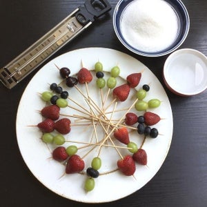

Skewer fruits on bamboo or wooden sticks. If using strawberries, one or at the most 2 is enough.
You can also use a mix of fruits but make sure they do not exceed in number by 3 on each stick. Makes it easier to dip in the bubbling sugar syrup.
Place these skewered fruits near the stove top where you will be making the sugar syrup to make it easy to dip in syrup as soon as it comes time to dip them in sugar syrup.
Keep all the ingredients (sugar and water) as well as the candy thermometer ready.

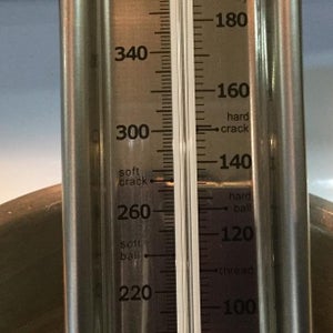

Place a candy thermometer in the pan to monitor the temperature of the sugar syrup. Here, you need a “hard crack” stage in the syrup which is achieved at 300 degrees Fahrenheit.
If you do not have a candy thermometer, follow the instructions to check when you should dip the fruits in the syrup in an alternative method given in "Notes" section.
Step 4:
Keep boiling the syrup on medium high heat, shaking the pan gently in between until it reaches 300 degrees F which is the "hard crack" temperature needed to make the sugar coating hard on cooling, once coated on anything.

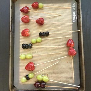

As soon as it reaches that “hard crack” temperature, start dipping the fruits one by one (tipping the saucepan ever so slightly so that the syrup pools in one section of the pan) until fully coated, twirling as needed.
Allow the excess syrup to drip back in the pan and then place the sugar syrup coated or candied fruit stick on the silicone mat lined pan kept next to the pan. This process should be done as quickly as possible at the same time taking care to not burn yourself with the boiling syrup!
You can also spoon the syrup over the fruits on the sticks when the amount of syrup reduces, rotating the stick as you drip the hot syrup.
Make sure to immediately place the sticks on the mat.

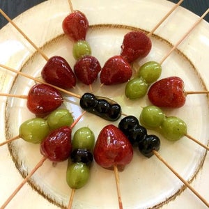

Continue dipping and setting them to harden until you run out of fruits or until the sugar syrup turns hard.
Let cool completely. This will take about 5 minutes.

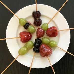

Once cooled, enjoy crunchy, edible glass candy coated fruits as a snack right away.
These candied fruits or Tanghulu as they call it should be consumed the same day. As time passes the moisture in the fruits will melt the sugar in the coating.
