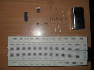

Step 1: Step 1: Parts List
1. Bread Board --1x
2. LM324 --1x
3. 100K POT --1x
4. 10K (1/4 W) --7x
5. 100K(1/4W) --3x
6. 0.1uF – 2x
7. 0.01uF –1x
8. Battery --1x
9. Wires.

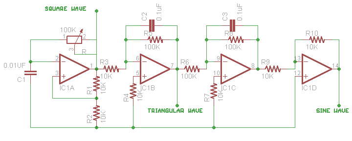

Step 2: Step 2: Schematic
LM324 consists of 4 operational amplifiers. All the four op-amps are used to generate square, triangular and sine wave.
First op-amp is used to produce a square wave and it shaped into triangle wave by integrating it with second op-amp. The second op-amp is an integrator circuit.
The third and fourth op-amps are the wave shaping circuits which are used to remove the sharp edges of the triangle wave and shape it to a sine wave.

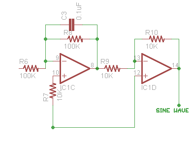

Step 5: Step 5: STAGE 3
The stage 3 is a wave shaper stage consisting of two op-amps.
This stage is used to remove the sharp edges in the triangle wave and to make it a sine wave.
Thus the output of entire circuit is a sine wave.
The frequency of all the three waves are identical and can be varied by varying the trim pot R.

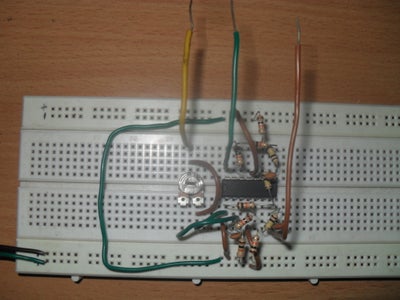

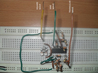

Step 6: Step 6: Breadboard Assembly
Assemble each component in the breadboard as per the circuit diagram.
If you decide to use this circuit for future use, it is better to assemble in a dot board or in a PCB.
The output may not be a pure waveform. It might have some disturbances but it is not bad when comparing the cost of buying a new one.

    This project doesn't work. The first stage doesn't even work. Either there is a mistake in the schematic or it never worked... There are a number of comments below mine saying the same thing with no update, response or reply, so effectively you've had the best of intentions to educate others but instead created frustration, misinformation and wasted the money of the folks that tried to build this. For those that are struggling, don't waste your time...

    This link https://www.efxkits.us/square-wave-generator-circuit-using-op-amp/ describes a nearly identical project and contains a more detailed schematic. I've included that schematic here, in case the link goes bad in the future. It refers to the LM1458 op amp, but I suspect than the LM324 can also be used. The LM324 is getting on in years now and there are better ones, but one of the advantages of the LM324 is that it's cheap and can be powered by a single source. I've been using the MC34074AP as a plug-in replacement for the LM324 and have been very happy with it.

    From the LM324 Datasheet, Page 17, Figure 27:
    TI shows a square wave oscillator without the pot. In their schematic they show a resistor to the + pin (3,5,10,12 on LM324) from a v+ source. As soon as I connected v+ in this way stage 1 worked like a champ!
    The reference resistors from TI schematic are 100k.
    I've only got stage 1 working right now, but going to make the other stages next.

    What's the purpose of R6 on step 5: stage 3?

    Doesn't work per the schematic. Can't even get the Stage 1 working. Tried a bunch of changes. Tried rebuilding it from scratch. Tried basing it on the photo of protoboard later in the steps (which is clearly different from the schematic), but couldn't be sure about some of those connections. One thing definitely missing is the ground connection. It appears, based on the photo that pins 3, 5 and 10 are connected to ground via the 10K resistors, pin 12 is direct to ground. But based on the photo it doesn't look like pin 2 goes to ground via the cap, but based on the schematic, if those other 4 go to ground, so should pin 2, via the cap. So something's not right.

    The last opamp lookslike an unity gain buffer, or has it some other function that the 2nd integrator is not doing? I am going to build one with a 555 and 2x741. Maybe a third one as output buffer/amplifier.
