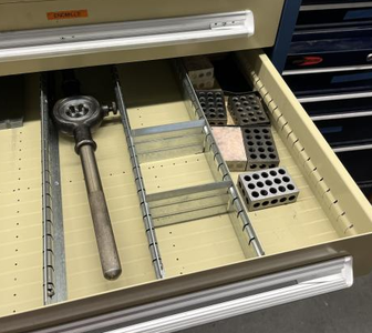

Let's start by getting familiar with all the tools we'll be using. You can find any drill bits either in the box on the table right in front of the lathe or in the metal cabinet right outside the machine shop. The chuck and the chuck key (2nd pic) can be found in the 2nd drawer of the tool desk to the right of the lathe. You can find the taps and dies(4th and 5th pic) in a blue box on top of the large wooden cabinet(4th pic). There are calipers on the tool desk next to the lathes. Finally, you can find the Allen keys on the tool desks by the mills.

To finish off the cap, we just have to tap threads for the body to screw onto. To do this, you will not have to turn on the lathe for any of these steps. Start by finding the tap follower (3rd pic) in the drawer in front of Joe's desk above the drawer that says edge finder. You can also find the tap holders inside the metal cabinet by Joe's desk(1st picture). From the tap box, get the 3/8-16 tap. Put the tap into the correct size tap holder and tighten the fastener to secure the tap in place. Now go ahead and put the tap follower inside the tailstock chuck on the lathe and line up the tap between the drilled hole and the tap follower as shown in the fifth picture. For tapping, since you aren't using the lathe, I like to lift up the safety screen to make sure the lathe doesn't turn on accidentally. To start tapping, apply some cutting oil on the tap and the part and wind the tailstock out so that you preload the spring in the tap follower. You can now start rotating the tap away from you to begin cutting the threads. With the tap, you want to ensure that you are breaking up any chips that build up, so for every 1 full turn you make, unscrew it by half a turn to break the chips and then continue onto your next turn. Keep on repeating this until you feel the tap has reach the end of your part and has a lot of resistance. You can now full unscrew the tap and your part should now have threads. Feel free to check out this video in order to get a walk through of how to tap: https://youtu.be/769r9jE4Phs?si=Kiz9ggUnppbFjKkX.

Once the shoulders of the body are created, you can use a die to create threads on them. You can grab a 3/8-16 die and a die holder from the blue box that we got the taps from. The die has a set screw that you can use to tighten the die. Make sure the side of the die where the cutting grooves are slightly chamfer is the side that you put up. Grab the knurling tool or any of the other large tools with a flat face and put it into the tool post. Line up the die and the tool post so the die is concentric with your part and is flat against the tool post(as shown in pic 2). Using the die is similar to using the tap - use cutting oil, rotate the die away from you and for every 1 full turn, back the die out by half a turn to break up chips. As you rotate the die, also move the tool post in the y axis so that you're applying pressuring on the die to keep it straight. Keep going until the die runs into the shoulder and you can't rotate it anymore. Once you have done that, back the die out and flip the orientation of the die inside the die holder so the side without the chamfered grooves is on the top. Then line up the grooves of the die with the threads on your part and repeat the process with the new die orientation. This is in order to cut the threads by the shoulder of the part since the original die orientation didn't fully cut the threads since the die was chamfered in the front. Repeat this for the other shoulder of the pen.
