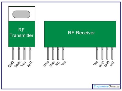

After doing this you need to Send Data wirelessly. Just connect 13 and 12th pin of arduino to the 13 and 12th pin of Encoder (HT 12e) See the circuit diagram that i posted and Data sheet on the given link below. and connect 17th(OUTPUT) pin with the Transmitter(RF module).

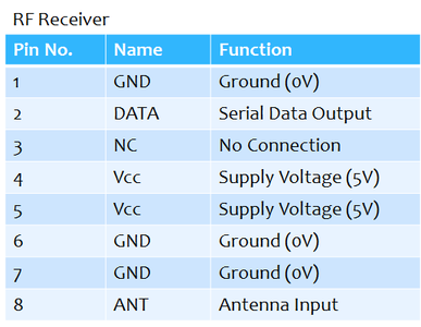

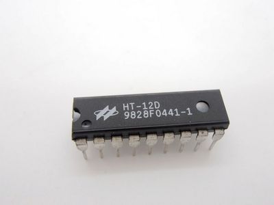

Step 4: Receiver Side
Now come to Receiver side. It is quite Simple. you just need to connect the Receiver of RF module with Decoder which will decodes the Received Data coming from transmitter. Connect the data pin of RF module with the pin number 14 of Decoder and out put of Decoder from pin 13 and 12 to the Relay. Don't forget that Vcc here is 5v.
Datasheet of HT 12D Here.
